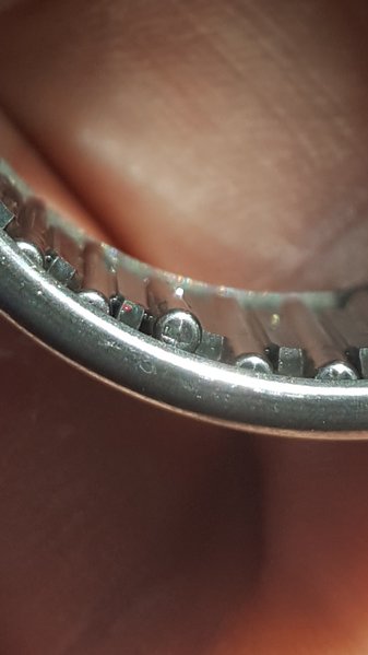

    Is the vibration caused by the OEM bushings failing or just bad fitment in the first place? I've been lucky no vibes 30k on truck, 12k since lift. Considering preventive swap before wear on my axle.

    TLDW ok I see a needle bearing out of place in the pic this is the failure? Confused

    2wd trucks have no front differential, therefore, no cv shafts, no needle bearing.

    They all do.

    Needle bearing with slightly improved tolerances. Still not as good as the ECGS bushing in lifted applications AFAIK.

    i was wondering how they weren't having an issue from factory, but after some research I realized they had no lift provided.

    For what its worth, I have already replaced the needle bearing, but I asked my dealer, and they said they would not warranty it because my truck is lifted and that is what caused it to fail.
    I when I ordered my ECGS bushing they said that they sell quite a few of these bushings to dealers, doubt any dealer will admit it though.

    It looks like you are moving your cv shaft in and out which doesn't have anything to do with the bearing. Up and down or side to side play is what the bushing will help with. Also everyone I've seen that has the problem is able to make it go away in 4hi.
