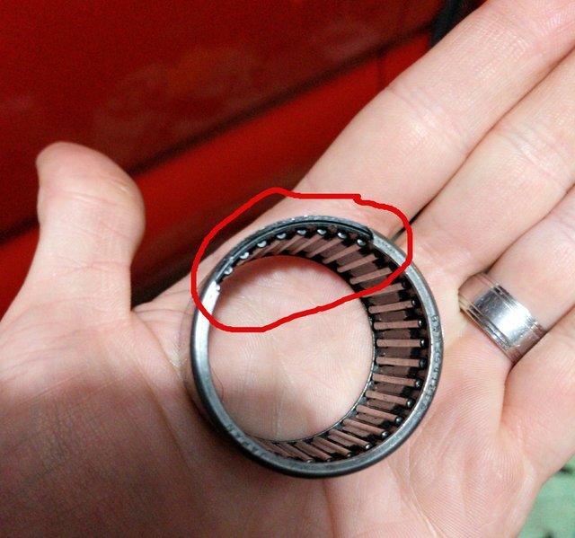

    See! Twins! Mine broke towards the center of the diff too when the tool broke it. I hope yours didn't leave the shard inside the diff. I was lucky to fish mine out.

    Agreed, its the tool that damages the bearing. My 2nd and 3rd gen were the same. Also had to fish out pieces. I used a small magnet and carefully felt around with my finger.

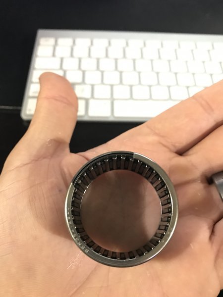

    I just changed mine this morning finally, wow I didn't realize how bad it really was until after the test drive and what I was hearing/feeling is 100% gone now, so happy. When removing the OEM bushing it broke exactly like what has been posted here, luckily I saw what has been posted and looked for them immediately and got the two pieces with a magnet. I think ECGS should include that note in the install instructions so people are aware to look for them.

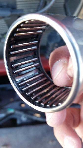

    vibes gone....here is an idea, why doesn't Toyota update their damn bushing as that seems to be an issue even on 2nd gens. Look inside the bushing...some of the pins/bearings broke creating vibes

    just to post again. this needle bearing has been a known issue since 1995 on 1st 2nd and now 3rd gens. I seen no excuse as to why this hasnt been fixed either.
