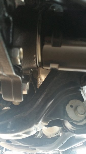

    Installed today. Vibe gone. Kind of a bitch. My needle bearing was pressed in way below flush so the ECGS tool did not work. I had to use a blind hole puller and get the needle bearing to move out a bit then the ECGS tool worked beautiful.
    I had the vibe instantly after installing 5100s, and I only went to 1.55" in front.
    Only thing is I am not sure I put it back together right. There is in-out play in the CV, I can't see how. I put it in as far as it would go and the dust cover seal sat flush. Then on test drive it moved out (see photo), but then I tapped the CV in again. No leaks -- yet. Does the drivers CV have more in-out play than the pass? It seems this thread discusses that but I am not sure if its the same movement discussed.

    Your cv will have play in and out, it's normal. As long as it's locked I'm with the spring clip, which by the pic it is.No vibe and no leak :thumbsup: id say your good to go.
    socal4x likes this.
