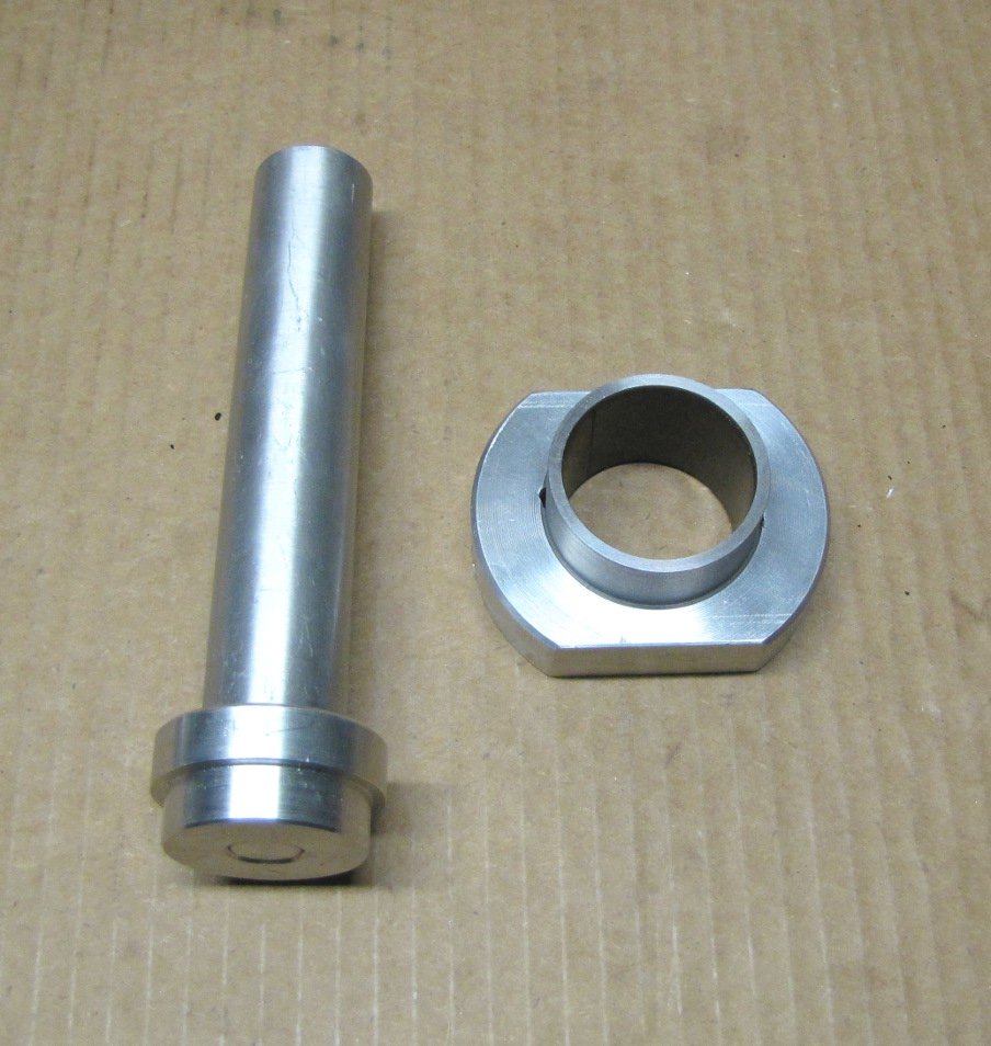

    ANyone know what size the bushing is so i can order the correct driver set from Amazon???

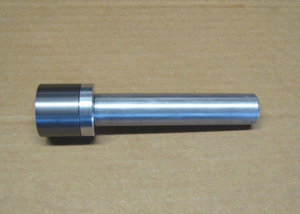

    I don't know what size driver pilots are available in, but I made my own I made my own custom aluminum bushing and seal drivers, and the pilot for the bushing ended up being 1.377 diameter for the ID of the bushing and 1.587 diameter for the OD of the bushing. the ID diameter is a couple of thousands smaller in diameter then the ID of the bushing, and about .006 smaller in diameter than the bushing OD.
    I also made up a bushing guide out of a scrap piece of aluminum that drops down into the seal bore to keep the bushing square and aligned to the hole so that it goes in straight.
    smitty99 and Taco1999[QUOTED] like this.

    39.5 , but it is not uncommon to have to file the driver down a bit to get a snug fit in the bushing.
    Taco1999[QUOTED] likes this.
