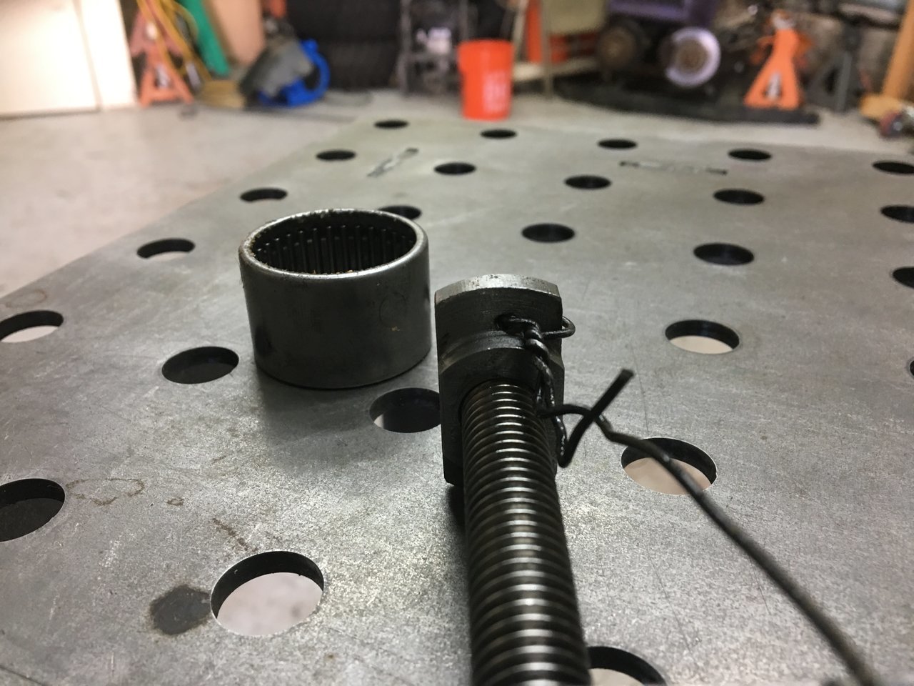

  9. Nov 7, 2017 at 6:58 PM
    #589
    PB FAB
    PB FAB Well-Known Member
    Apr 11, 2017
    #215942
    805
    2017 SR DCSB 4x4 v6
    I modified the ecgs bushing tool. I was worried about it falling into the diff. I drilled a small hole near the center and tightly wrapped bailing wire around it. It made it very easy to maneuver the piece. Just make sure the wire stays to the side so you get a flat contact on the needle bearing.

  10. Nov 7, 2017 at 9:49 PM
    #590
    Clay7160
    Clay7160 Well-Known Member
    Aug 15, 2016
    #194623
    1,281
    2018 MGM TRDOR DCLB 4x4
    GYEON ceramic coating
    I was just thinking about doing the same thing, but using safety wire that I did my big brake kit with
