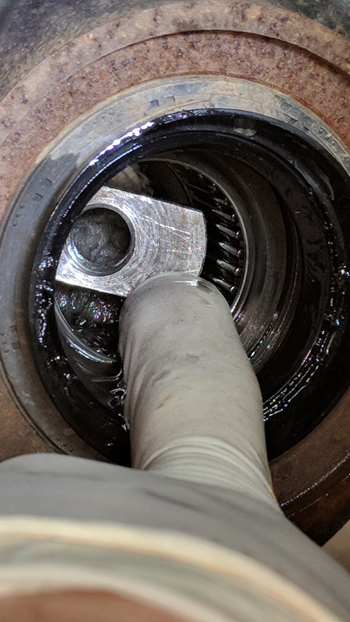

  9. Nov 30, 2017 at 11:31 AM
    #609
    Kohan21n
    Kohan21n A caffeine dependent life form - IG @dizzy.trd
    Jan 28, 2010
    #30229
    1,198
    Nazareth, PA
    2016 DCSB MGM 6MT
    First pic, can see the bushing is not even with the housing.
    mcharfauros likes this.

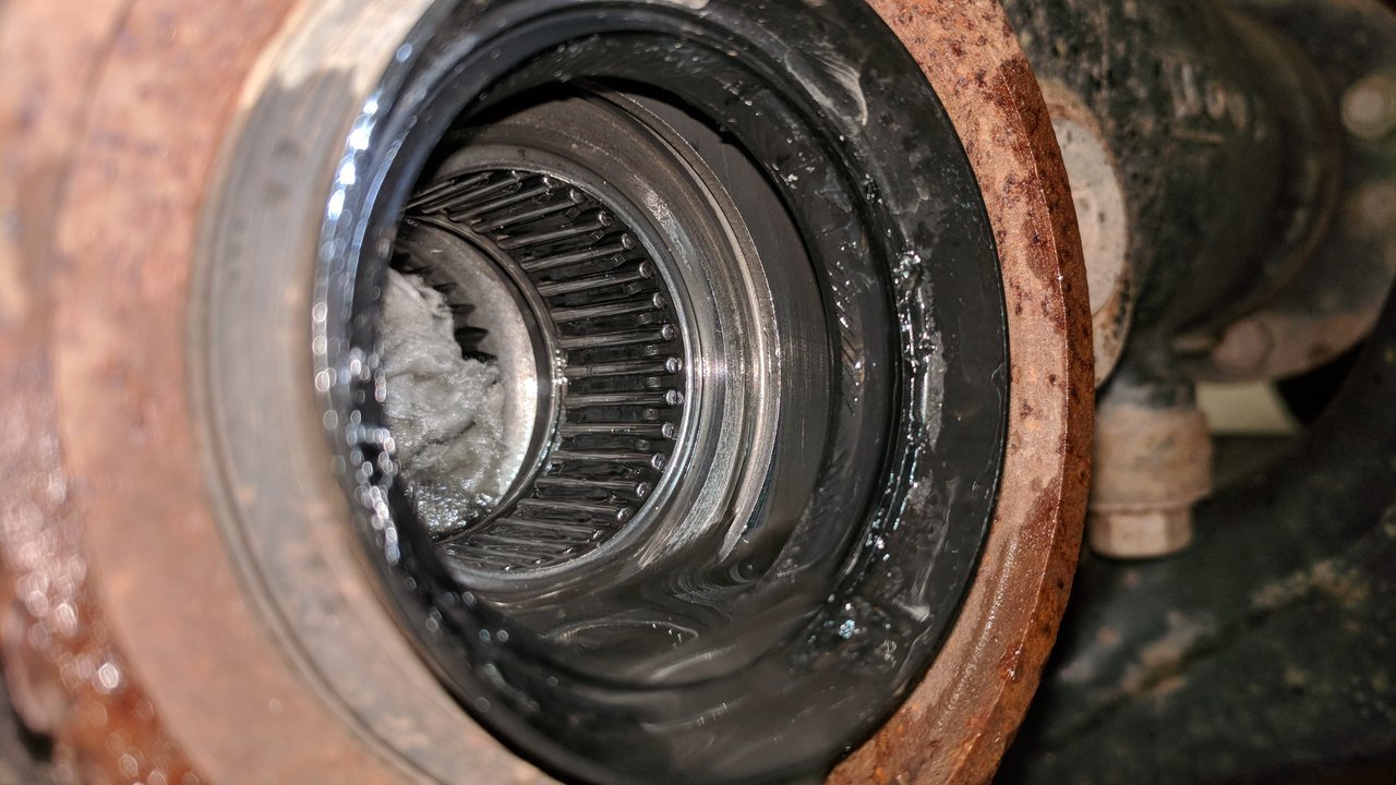

  10. Nov 30, 2017 at 11:33 AM
    #610
    Kohan21n
    Jan 28, 2010
    #30229
    1,198
    Nazareth, PA
    2016 DCSB MGM 6MT
    Second you can see I still have about 30% of the bushing to clear before it falls into place. Now sure how to get the needle bearing out if it slide in somehow.

    I see what you are talking about, you can try pushing your wading back into the carrier a bit more. I’d try to get the tool in ther at an angle standing up, then try tapping the tool in a bit.
