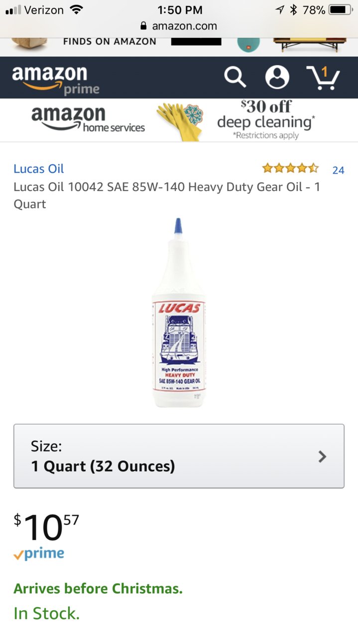

    Is this what most are using after gear oil? I believe this is what Ecgs is recommending.

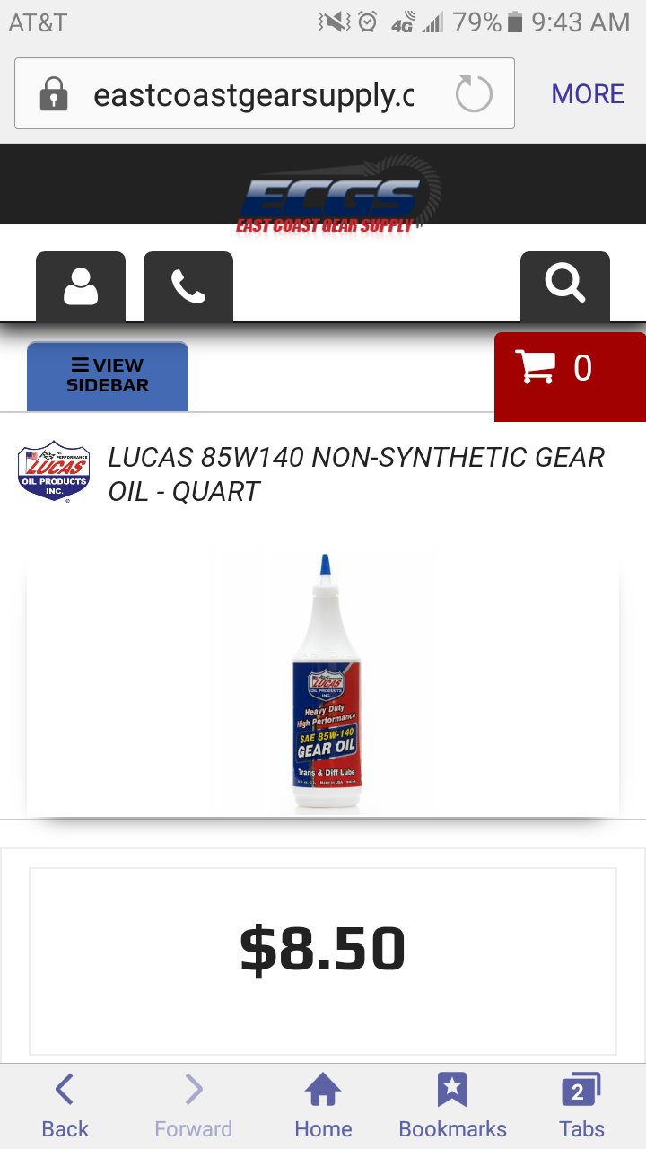

    Screenshot_20171109-094327.jpg I used that since they recommended it. 8.99$ at autozone. Takes 1.6 qu according to manual.
