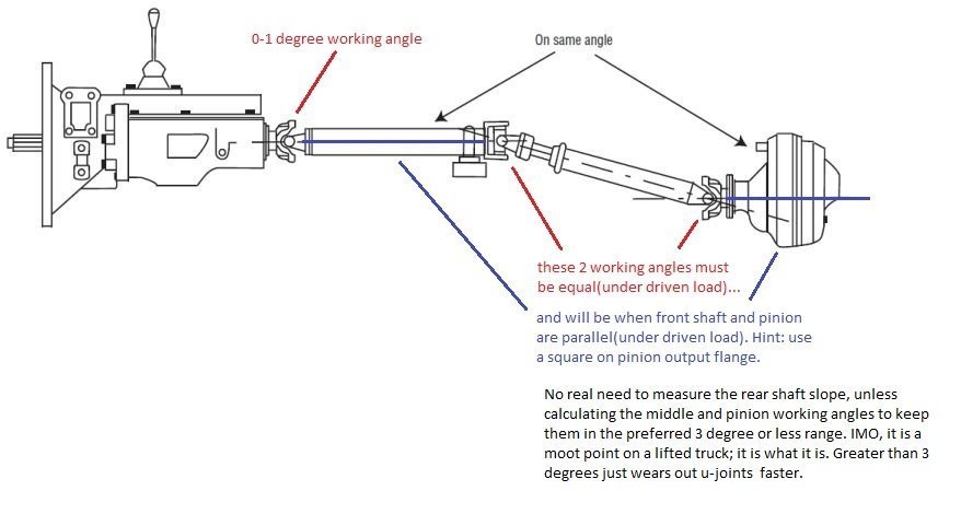

    Actually I took the carrier bearing out and remeasured my angles with an actual angle finder device and the difference of my working angles averages 1 degree to .4 degrees (measuring multiple times with some truck movement to ensure settling). The vibrations are less now without the CB spacer and the difference in working angle tells me the 3 degree shims would be better than my current 2.5 degree shims getting my working angles very near cancelling each other out (.2-.5 degree difference). Many people have generously given advice and many say with a 3" or less lift that spacing the carrier bearing is unnecessary and can actually produce more vibes.
