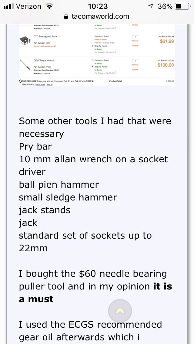

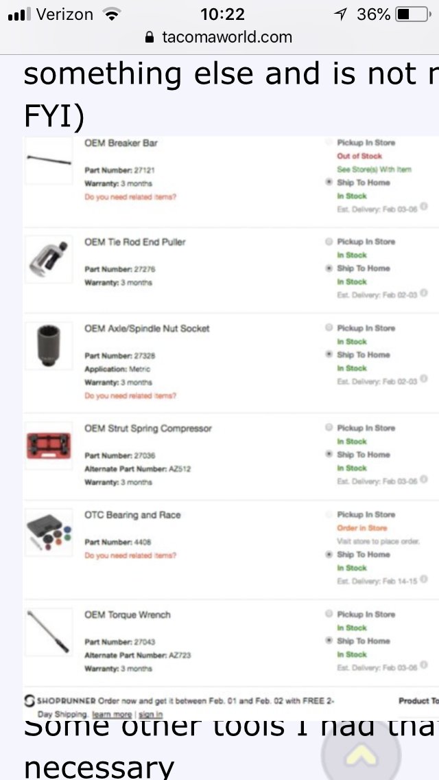

    Would anyone be willing to share a tool list of everything I might need to do this? I want to make sure I have everything I need before beginning.
    Thanks

    Took a screen shot of another members post which help me get all the tools needed. The one of the tools he rented is a little blurry, hope it helps 3DBB2F12-9095-4A6B-B08C-B3624B803F78.jpg942B7488-5ACC-4287-97F3-11EA3CF3E5AB.jpg

    Thank you sir

    I'll chime in on the tools.
    You can get this job done with a basic set of hand tools, large sockets and a torque wrench. Helpful pieces are a mini pry bar, dead blow hammer and mechanic's pick set. My bearing came out mostly whole, but I had to track down a few small metal shards. They were hiding in the channel behind the bearing seat. Those little picks were the only tool for the job.
    JethroFF likes this.
