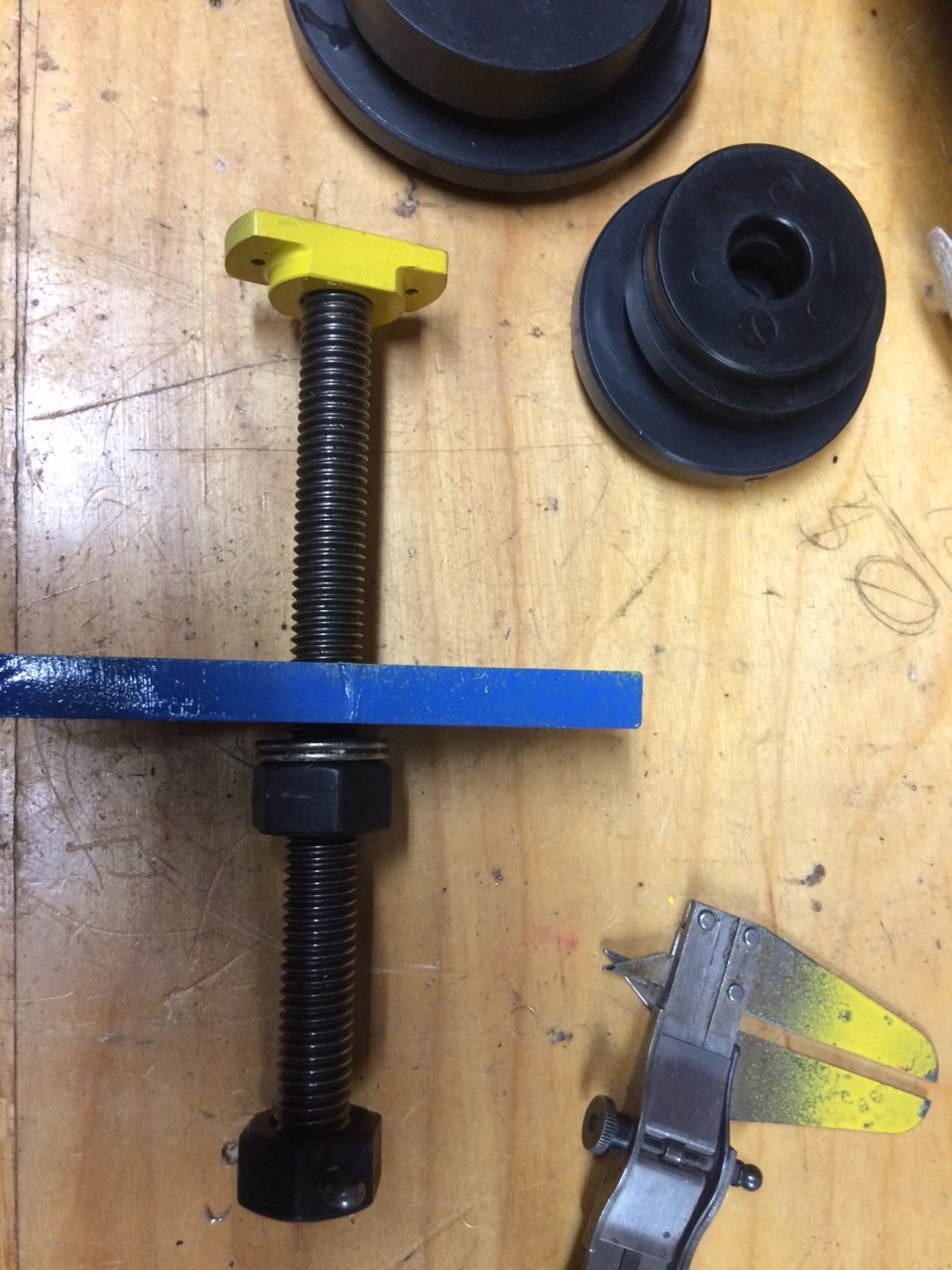

    I ordered and received the ECGS bushing and install tool. Waiting for my 6112's to get here so I can do both at the same time. If anyone here lives in the bay area you can borrow the tool after I get done using it...just leave me a pm for details..
    Updated removal tool, deburred edges, pinned the end nut to keep shaft from turning, drilled two holes for better alignment and keep driver from falling into diff with a wire, painted hi vis yellow, added two thrust washers for smoother operation.IMG_3411 (3).jpg
