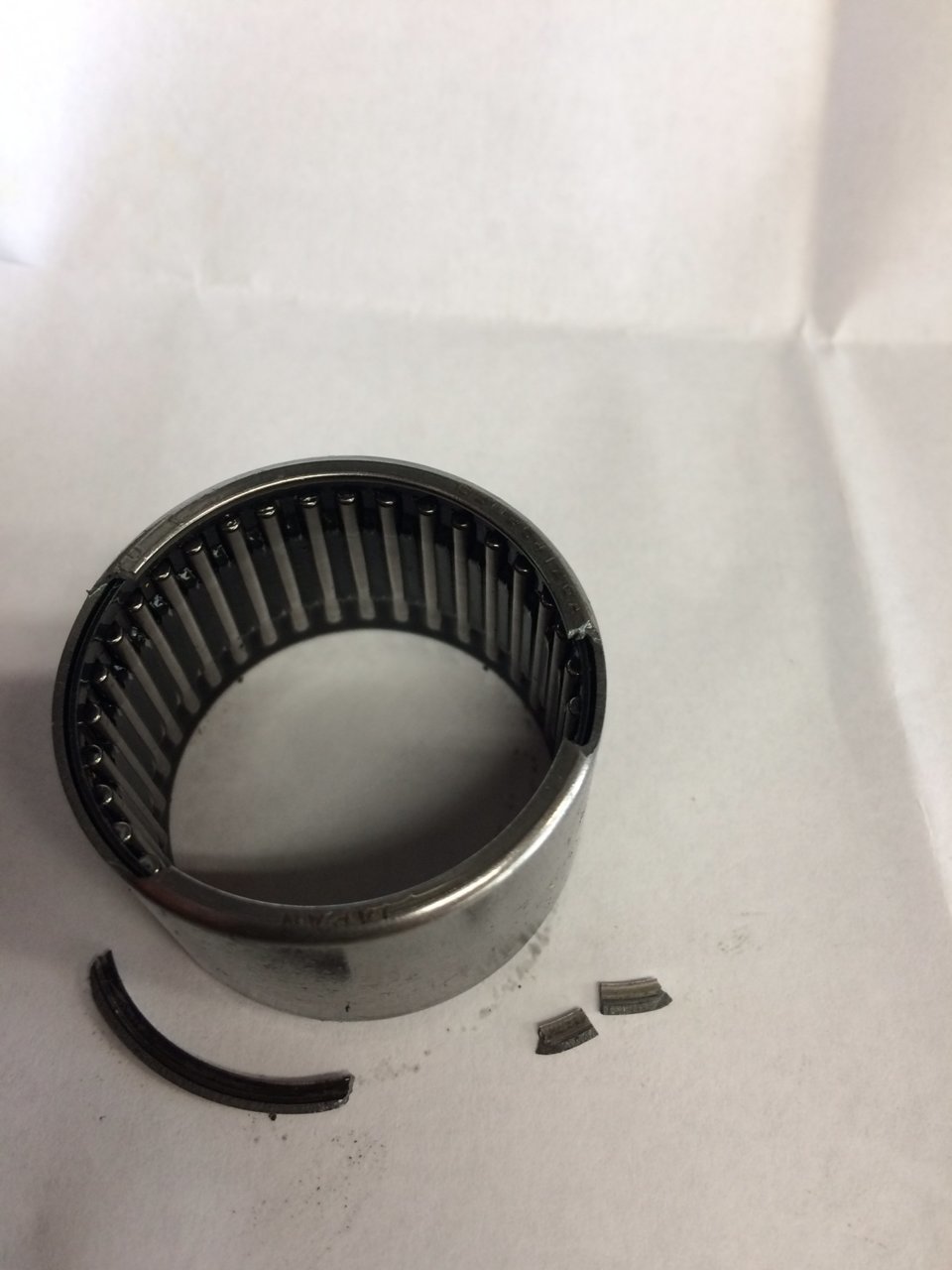

    Thanks for all the comments - I definetly have the same issue on my 2017 TRD OR. Been back and forward between Toyota dealerships blaming the vibration on the BFG ko2's for being over sized. I only installed a leveling kit providing a ~2inch lift... And of course 4WP says it has nothing to do with their work.
    Bottom line - like the original post said - even if I convince Toyota dealers and Toyota (I opened a case for them to reconsider under warranty) they would just be replacing it with the same faulty needle bearing.
    I have been experiencing this vibration for about 3k miles - ever since the lift was done.

    Got an early start this morning and did my bushing and 6112 install. Getting the puller in there was just like in the video. You need to tap it in there lightly to seat it then thread the puller in and wrench it out carefully. Worked smooth as butter. Just make sure that if the bearing frags to use a magnet tool to remove all the metal pieces you don't want them in the diff mixing around. I found that removing the bump stop gives you more room to tap the new bushing in. The needle bearing with 25k on them were a little to sloppy compared to the snug bushing. I wanted to make sure I get good reliability when doing the front end It wasn't making noise but didn't want to chance it.. overall the job was straight forward.

    Identical situation happened to me and bearing replacement then failure. Put ECGS bushing in and vibe is gone.

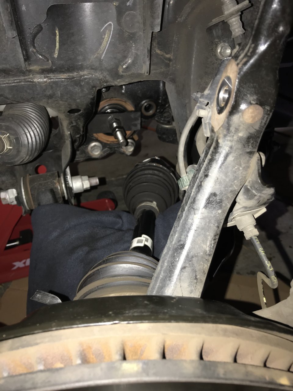

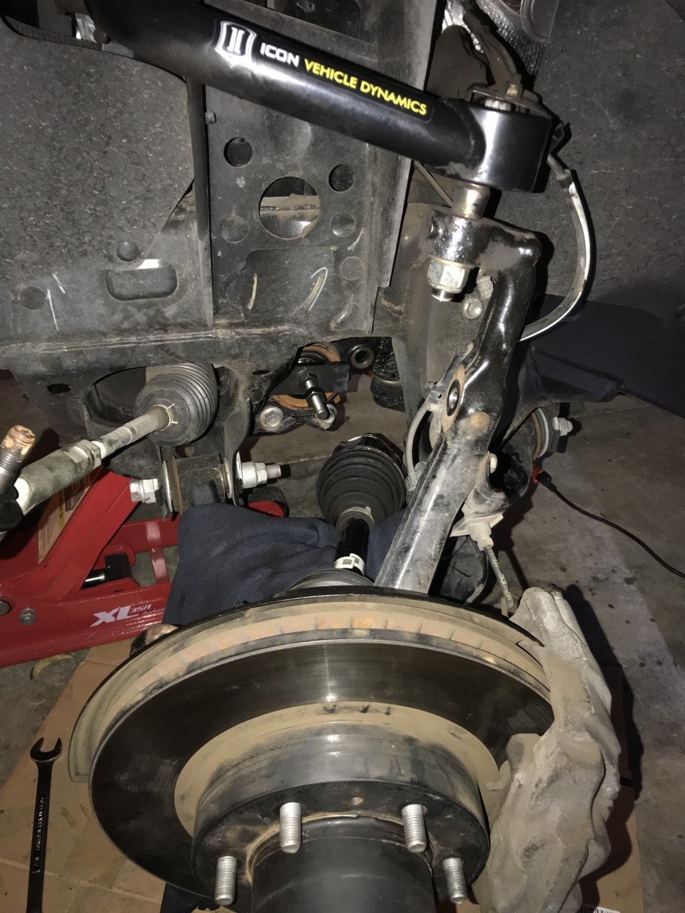

    Just installed the ECGS bushing this past weekend. I bought a seal with the intention of replacing it, but it still looked new and I was tired so I left it alone. I have a 2017 with roughly 17k miles. Hopefully I don’t regret it later. I guess time will tell.
    Edit: by the way, I think most people pull the whole axle, but I only pulled it from the diff and didn’t remove it from the hub. I read about someone doing it this way in an old thread. Here’s a pic of what I did. You’ll probably want to remove the C/O to make more room, but I think that’s easier than pulling the whole axle. Just another option.
