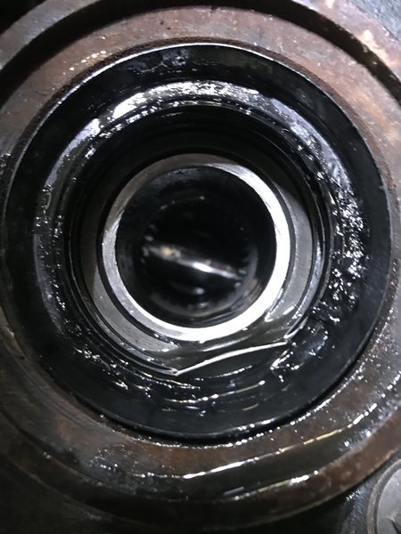

    The bushing is longer than the needle bearing, it should stick it out more.

    It needs to be FLUSH to 1/32 deeper (.032) max, yes the ECGS bushing is longer but that's ok ALL the instructions say to make it flush or just a little deeper,
    if it is out to far maybe the CV shaft is riding on the end ?
    not my photo

    that’s right, i knew it either stuck out a bit or sat in more. sorry man.

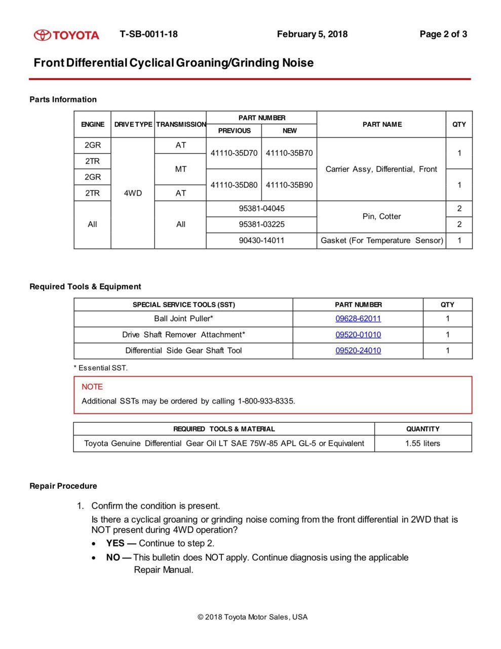

    So funny story. Friday I stopped at the dealer to get my oil changed since it’s 5 degrees outside and sleeting, I wasn’t doing it. I mentioned that my truck has a intermittent cylindrical groaning noise, knowing it was my needle bearing but hopeful to see if they would replace it. I mentioned it’s definitely drivetrain related, and the noise goes completely away when I turn 4WD on. They said they would look at it and let me know, yada yada, didn’t think they would go further than that.
    When my truck was ready, the went over the evaluation of the truck and my complaint. I might be late to this party, but turns out there’s a TSB out for this exact issue. It’s probably mentioned in previous comments on this thread, but I had to share. Anyway, they told me they ordered the front differential and parts, and would call me when it came in. They’re replacing my front diff?? Completely caught off guard, I say okay let’s see if this will fix it. Can’t hurt right?
    So today (Tuesday) I get a call that the part is in, and to drop my truck off tonight when they will fix it tomorrow first thing. I’m interested to see the outcome. I’ll keep everyone posted. Mind you, my truck is lifted 3” and they’ve always bitched about warranty work if any because of it. I’ve attached a copy of the TSB they went off of.

    They’re replacing your front diff with exactly what you have now, needle bearing included.
