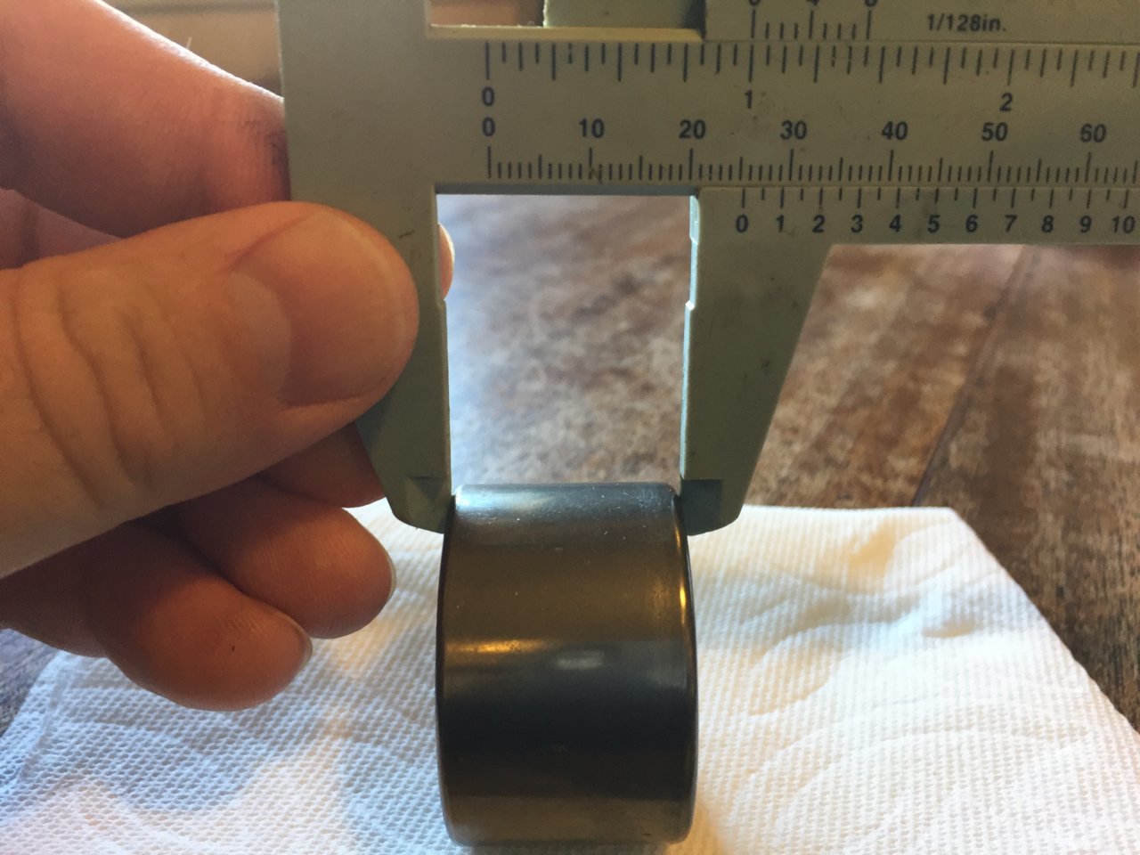

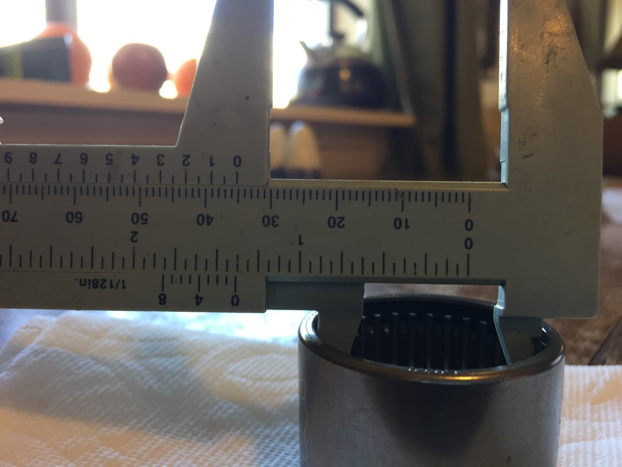

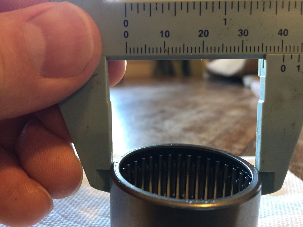

    That's probably what everybody does. Any one have the dimensions on the ecgs bushing?

    I still have mine, and can measure whatever you need, but it would be Saturday or Sunday at the very earliest.

    I'm not in a hurry. I would like to know the ID. OD. and length in mm please.

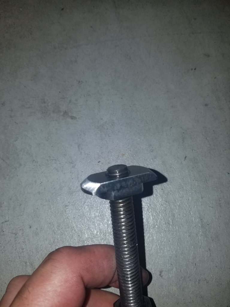

    No pictures we have a snowstorm going on right now the truck is useless, i ordered a new removal tool i hope this will work to get it out, i think i made a mistake that it was not set well the removal tool wouldnt fit right behind the needle bearing it was too tight

    If you grind the back side of the plate on the removal tool you can get it back behind the needle bearing more easily.
    I have my OG intact let me see if I can find it and throw a caliper on it ADK.

    Allright cool if you can measure it for me i will be able to see if mine is the right size before putting it in

    When you get the new one, grind the far side flat edges like this.....
    Do not grind off anything on the outermost edges and reduce the width of the tool.
    Ground like the above pic, and it will slip right into place, seat behind the bearing easily, and still have the proper strength and dimensions to get a bite on the bearing and pull it out. Prior to grinding mine, I could not get it into place no matter what I tried, and was not inclined to try and tap it into place for fear of breaking off a piece of bearing race.
