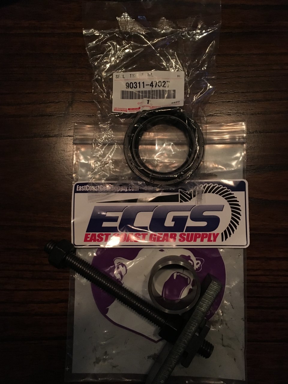

    2017 4WDV6LB6MT
    Trying to find the part number. I ordered one from ECGS with the solid bushing but it doesn’t list the OEM part number
    Ok I found this part number, double check it
    90311-47027
  15. Apr 4, 2019 at 12:07 PM
    #915
    FastEddy59
    FastEddy59 TTC #0061
    Jan 20, 2017
    #208155
    27,141
    Eddie
    '13 Barc. Red Tacoma SR5 4X4
    Here’s a Pic if the Whole Shabang.
    EPH and Grossomotto like this.

    Not enough to list
    Sweet! Thanks. I have the puller and bushing but I will add the seal then.
