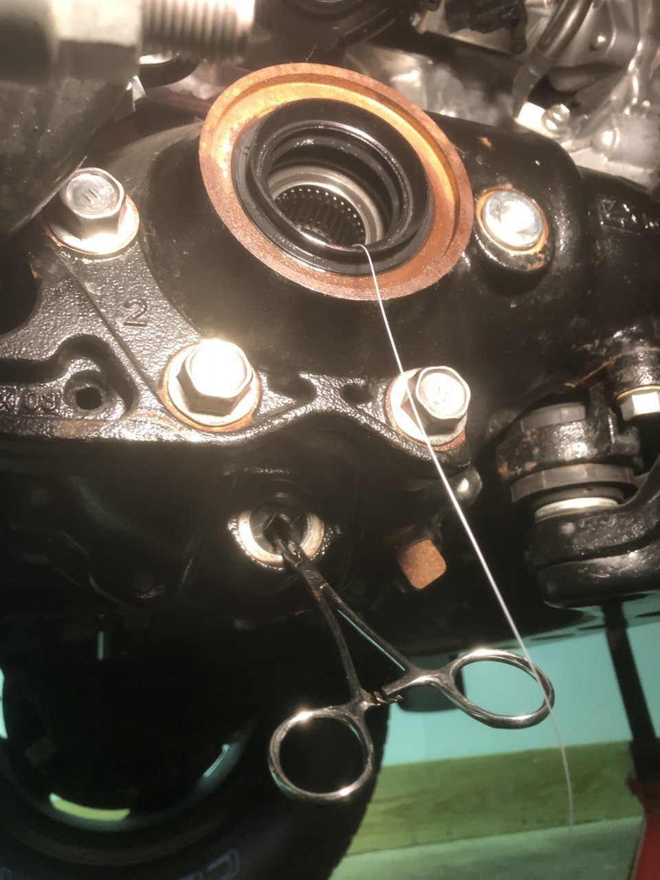

    Anybody have the unfortunate luck of dropping the back piece of the ECGS tool into your diff? If so, how did you get it out?

    Wow that sucks I'd use one of those flexy magnets that extend out.

    I did, it was not fun. You have to fish it out. Take off the drain plug, drain all fluid, get the piece visible in the drain hole, fish a piece of line down and through the cv hole, then tie onto the piece then pull it back through the top

    **So I still had the drain plug off and I could see the back part of the tool. I was able to fish a piece of coated tie wire in through the drain plug hole, through the tool and up out of the CV hole. I bent a hook on the end and I was able to pull the tool through. It was actually pretty quick and easy. After I removed it, I used a bench grinder and tapered the back side of the tool as others have suggested, that made it work much easier.
