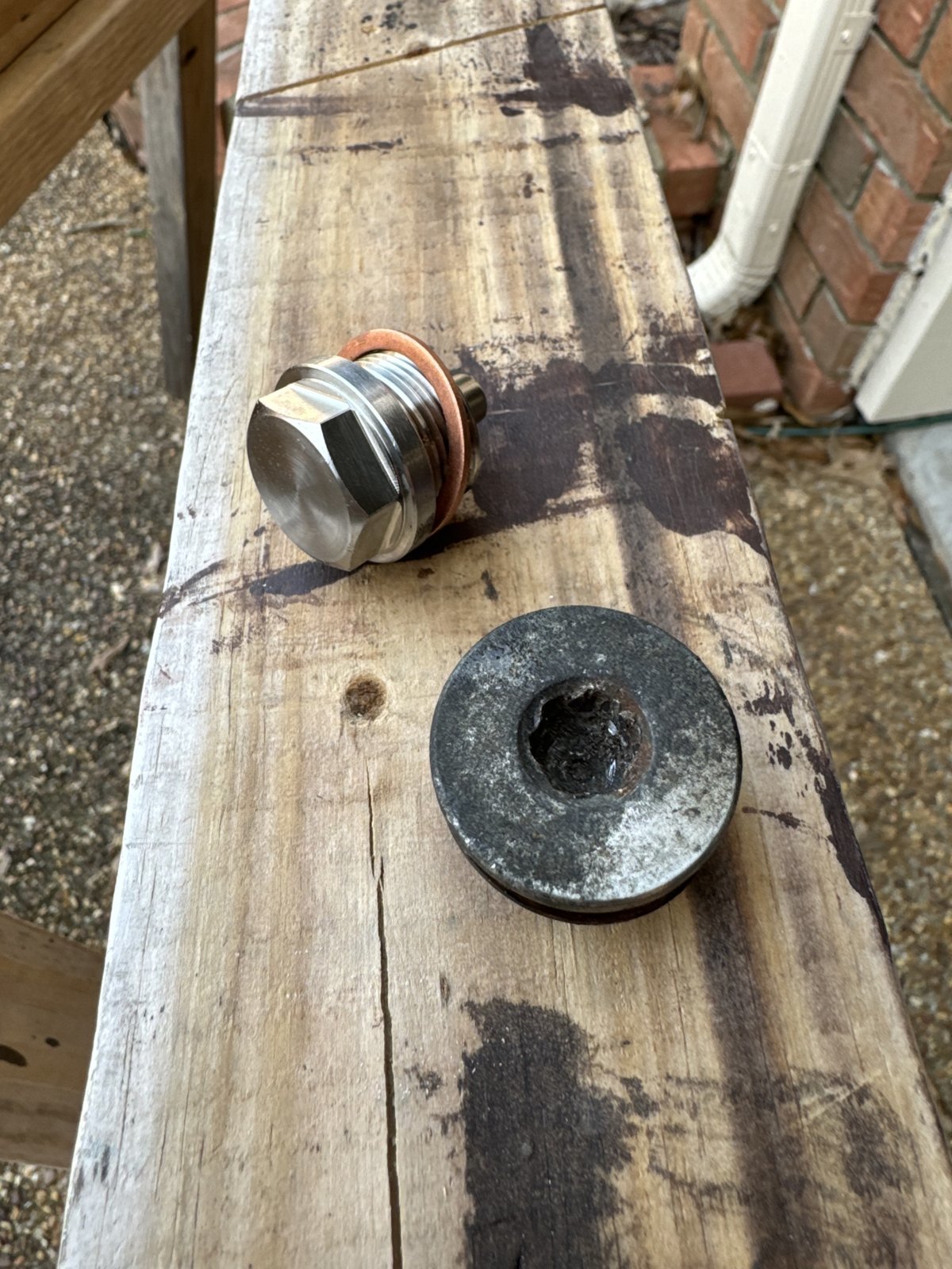

    To be honest, I had zero issues removing my old plug. Replacing it with the new plug was preventative in every way.

    I used a hammer to ensure the 10mm was seated and it came right out.

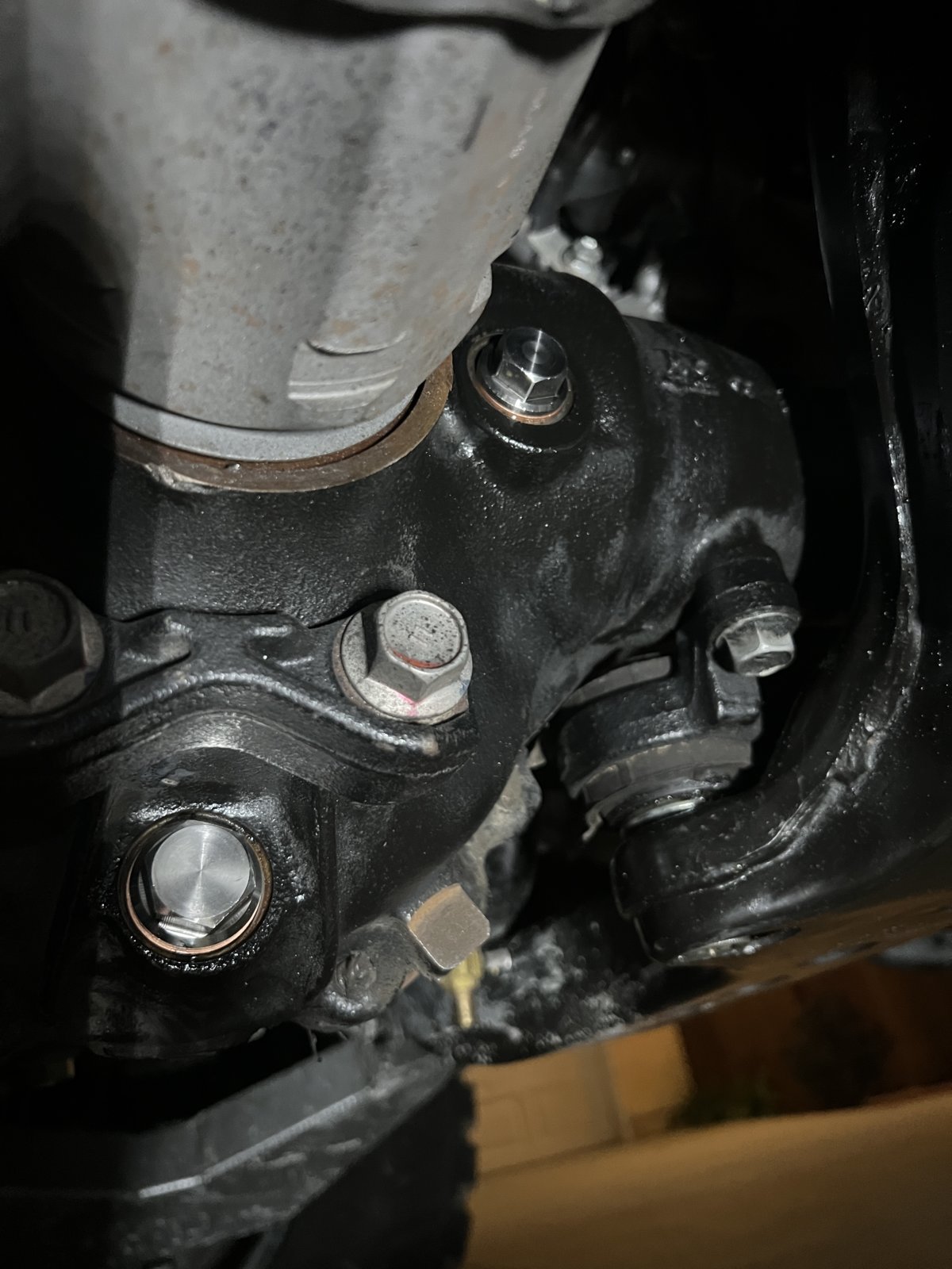

    You really want the fill plug as well, that ones a bitch to get off. I ordered these Lexus parts from SSL-Parts dot com a year and half ago. Shipped was $22 for both.
    90341-18060 FILLER PLUG $8.82 1 $8.82
    90341-24016 DRAIN PLUG $9.08 1 $9.08

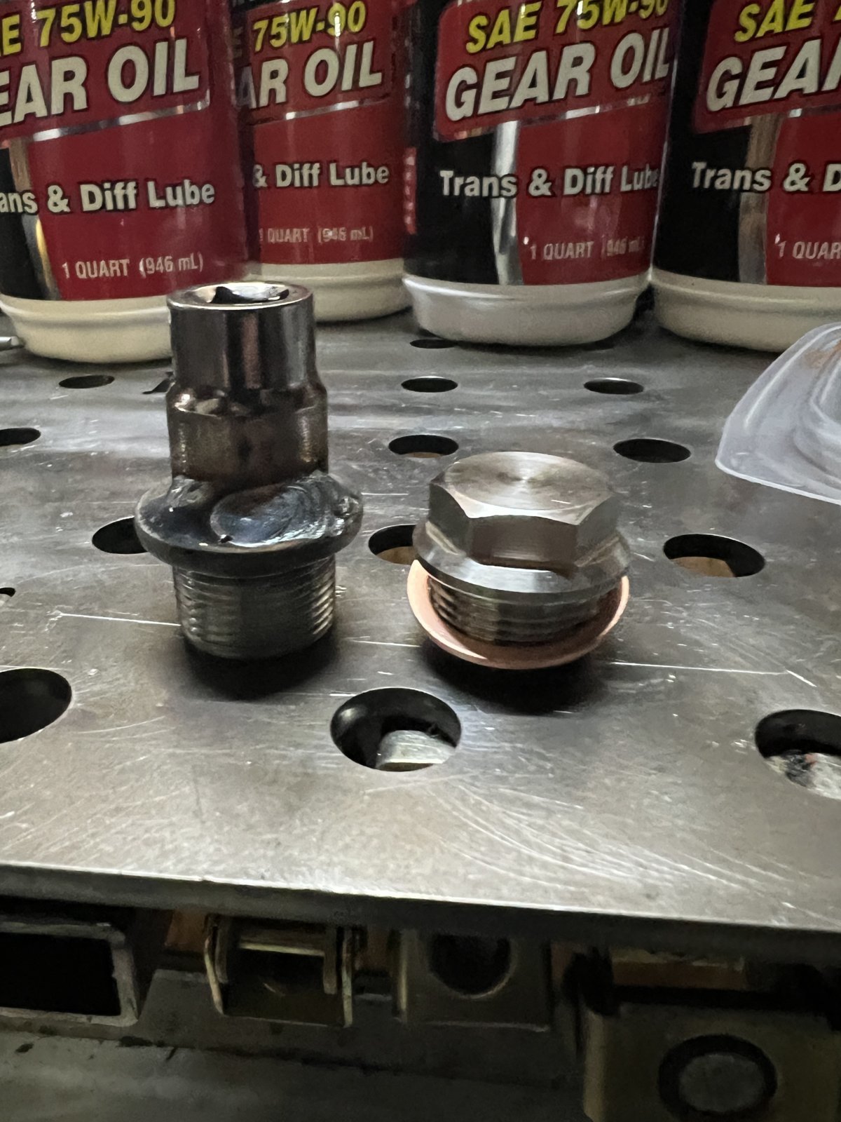

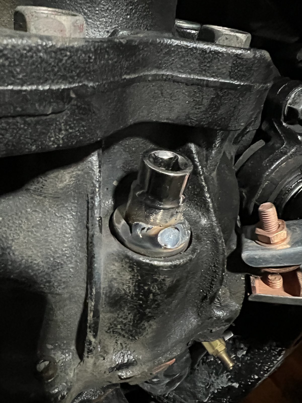

    Ordered a similar one but with a larger magnet for the drain and one with a M18x1.5 pattern to replace the fill plug as well. Of course the drain plug striped out on its last use. I welded an old socket on it and got it out with a ratchet.

    Fill plug is the same thread as your transfer case and rear diff. Front diff drain plug is larger.
    I actually use the front diff fill plug on the rear diff. Smooth profile so it can't catch on rocks and loosen.
