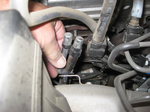

    Front differential and ADD breathers:

    any need to extend these are they pretty good length for the most part? I know rear needs to be done and will soon be completing that.

    Your airbox will be taking on water if these are.
