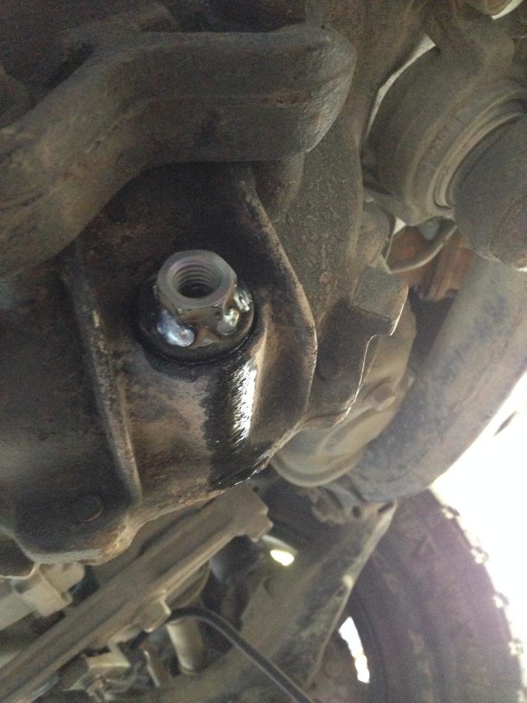

    If you repair it once like it should have came from the factory, you just use a 3/4" impact socket and it will come off every time.
