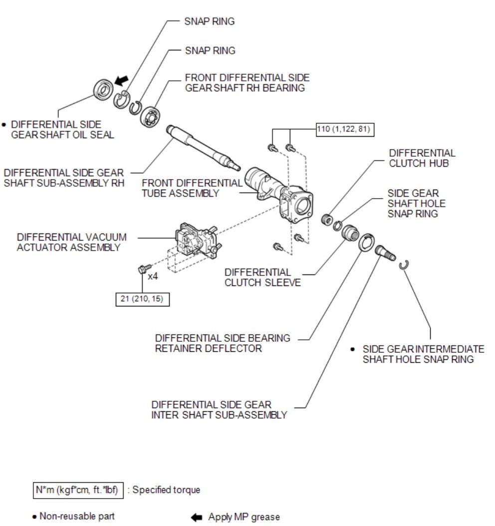

    My bad, I haven’t seen the full diagram. I understand the concept as it’s similar to my 90s Jeep with its front CAD, so I was making a small assumption. Thanks for clarifying.

    No problem. Here's the diagram.

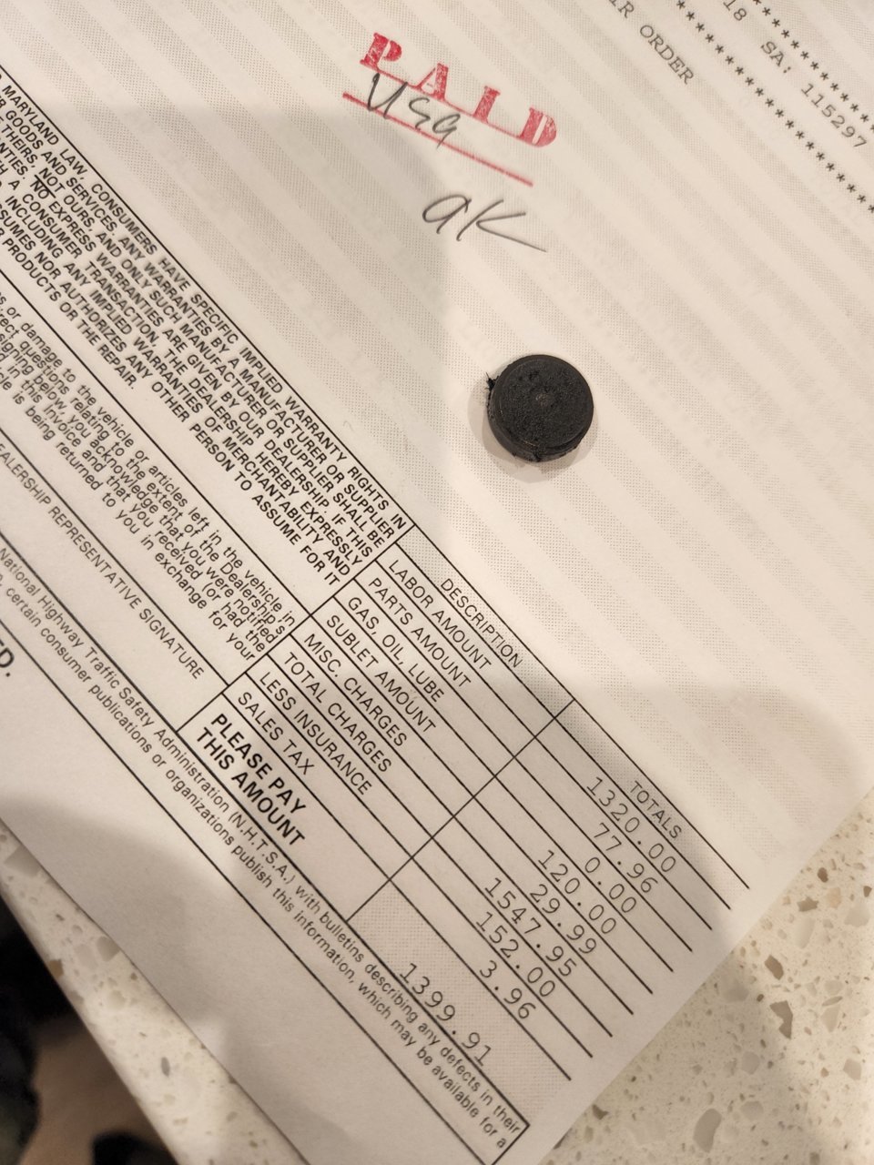

    For all who have wondered about this project, here is an update. I tried getting the cv axle off of the front for better access and failed... Cut my ring finger and split it open on accident with a crowbar, my fat came out of my finger and was pretty gnarly. I had to get two stitches. So after purchasing a borescope, bolt extractor, magnet wands, and over 4 days of trying I was spent and sent it off to the dealership to get it taken care of. Total cost? about $1,200 for their labor of taking the front diff off, splitting it open, and removing the magnet. I told them I wanted the magnet since I can use it on my fridge and show it off (might make it into a plaque) I will post pictures of the $1,200 magnet in a few days, lol.

    I can't quite "like" that post but I do admire your light hearted take on the situation.
    We will be waiting on the $1200 magnet pictures. :thumbsup:

    Damn dude...that sounds like it couldnt have gone worse. Sorry.
    Ill also be waiting on the infamous magnet pics.
