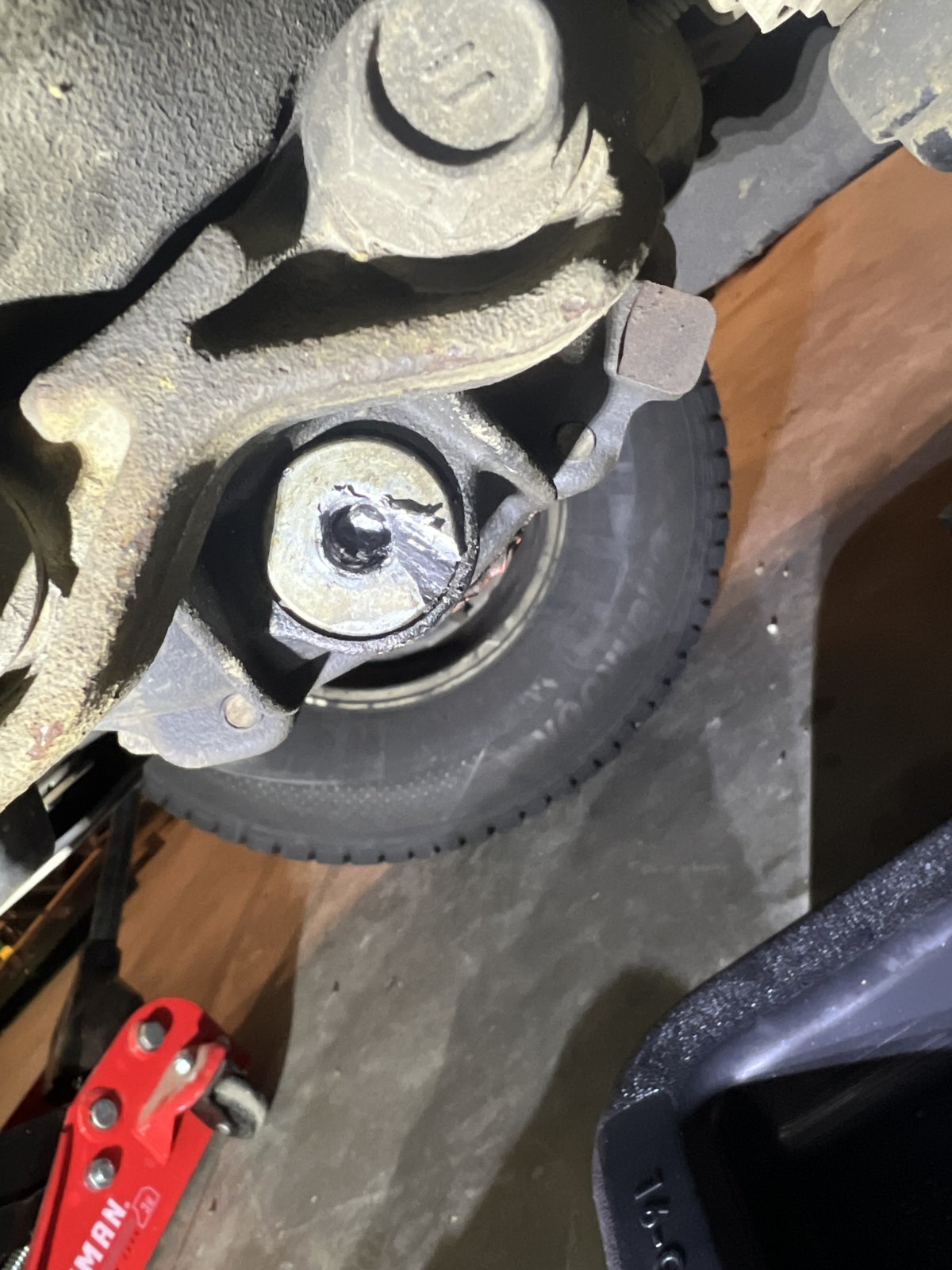

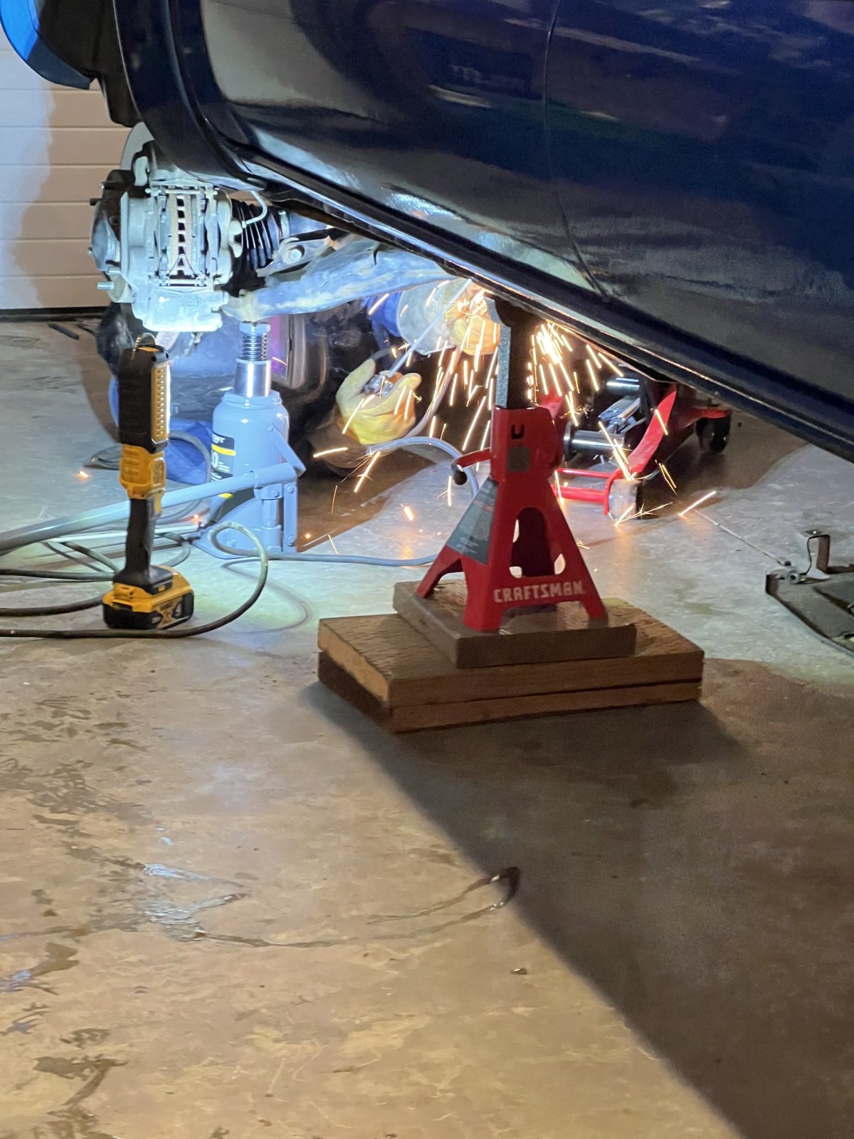

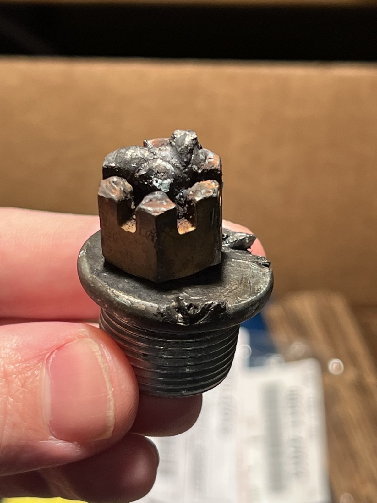

    Long time stalker, first time poster on TW. Just thought someone may be able to learn from my absolute self induced nightmare of a differential fluid swap..
    So there i was, thinking hmm.. “youre getting close to 200k, might be a good idea to do a complete reset of fluids and basic maintenance” all was going swimmingly until i got to the front diff..
    (i don’t know which engineer at toyota was on vacation the day they decided to make the drain plug up front a 10mm hex but i hope that guy stubs his toe every day for the rest of his life)
    like any good wannabe DIY mechanic i ensured i could loosen the fill plug prior to the drain plug..
    Step one : Strip the ever living crap out of the bolt.
    Step two: gouge the plug with a cold chisel after applying heat.
    step three : completely snap off EZ Out bit in drain plug (ensure you puncture all the way through to the diff. So now you have no option but to win this war) The magnetic chip cap was still attached THANK GOD
    Step four : do a terrible job welding a nut on the bolt (forget to leave the fill plug in so the heat causes the inner Diff seal to explode)

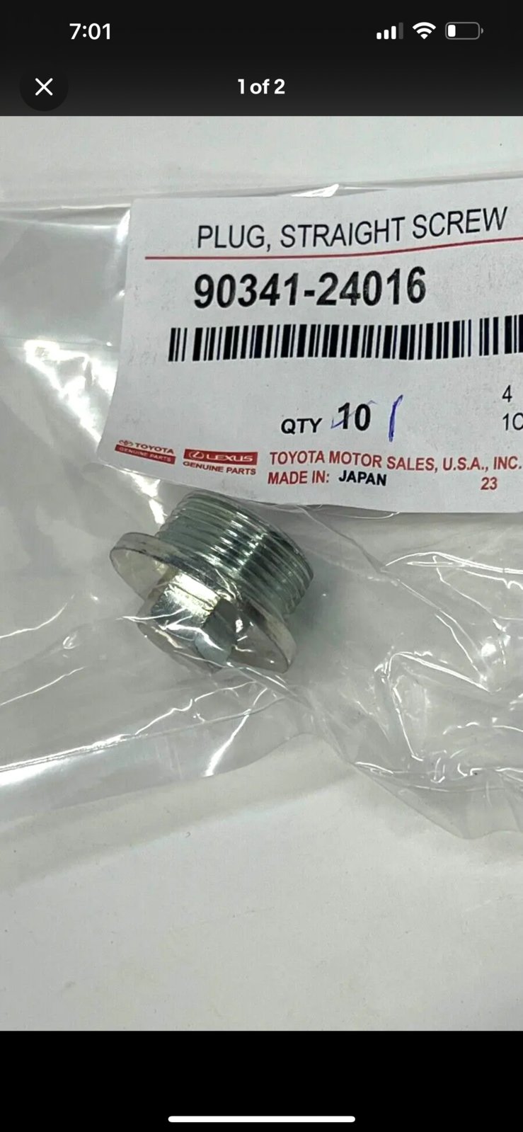

    Step five : remove stuck drain plug and replace with GENUINE LEXUS GS460 IS250,350 (06-21) FRONT DIFFERENTIAL DRAIN PLUG 90341-24016
    comes with a 14mm socket head
    Follow on steps :
    Replace inner Diff seal and throw on a new CV axle… because who’s isn’t leaking a little grease anyway…
    To wrap it up with a bow… don’t be an idiot like me.. and honestly swap out that plug for the Lexus OEM one at your earliest convenience..

    I went a different route. Had a shop break the plugs loose for the 1st time and install the Lexus plugs afterwards... less stessful.

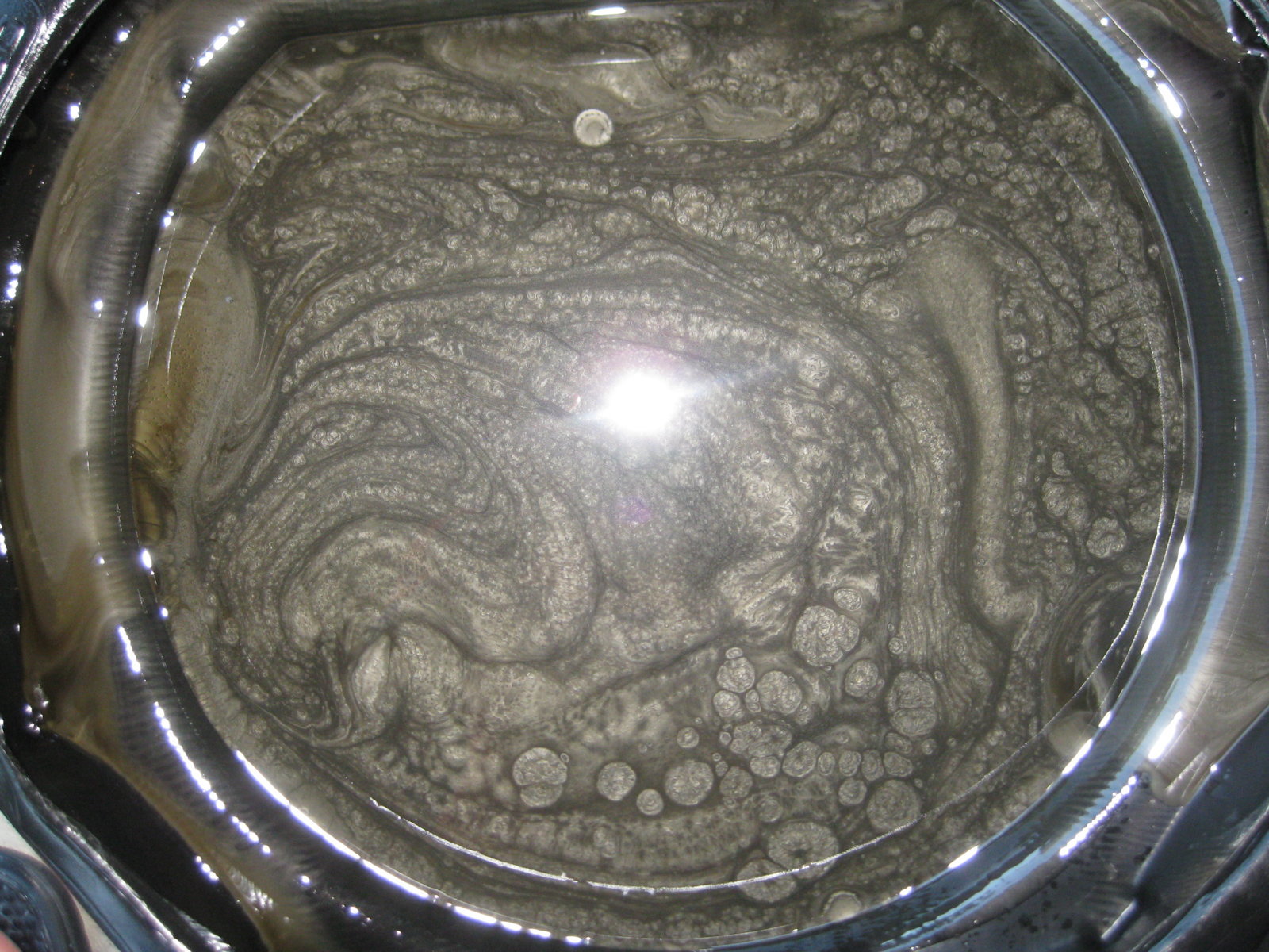

    Nope. I did rear diff at 1500. looked like a metallic silver milkshake. And IMHO this cant be good for diff bearings and axle seals...Also replaced the allen drain plug with stainless magnetic hex.
