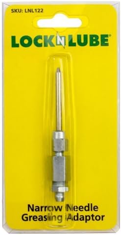

  10. Sep 5, 2021 at 4:35 PM
    OffroadToy
    OffroadToy old, forgetful, and decomposing
    Sep 12, 2009
    #22680
    6,776
    2007 Offroad DCSB AT- VSC,TRAC,HAC, & DAC
    Icon Stage 8, ECGS Bushing, Timbren bump stops, Crown braided/extended brake lines, Overland Custom Design sway bar links, rear differential breather extension, oil filter drain hose, a/c drain hose extension & reroute, front windows tint, Cat Security, XPEL headlight/fog & grill protection, OEM block heater, RCBS illuminated 4X4 switch, Sherpa Grand Teton/Crows nest, Baja Designs S8 light bar, Diode Dynamics SS3 Pro fog lights
    I bought one of these a while back for that zerk but haven't tried it yet...
    6 gearT444E and Tim v like this.
  11. Sep 5, 2021 at 5:08 PM
    george3
    george3 [OP] Well-Known Member
    Jun 8, 2008
    #7173
    4,551
    New Jersey
    2008 2.7 Manual Trans Tacoma
    Seat belt beeper, Cabelas (Weathertech) floor liner gray, Covercraft Seat Savers in Taupe, Protecta Heavy Duty Rubber Truck Bed Mat, Pop n Lock PL5200, Pace Edwards Full Metal JackRabbit, Wolverine oil pan heater, Scangauge2, afe pro dry s filter, Remote Underbody 4 Piece LED Light Kit (White) used as Bed light, DIY Washable Cabin Air Filter, PA15-TOY, 4x4 Illuminated Switch, full synthetic, Redline Tuning Hood Support, Smittybilt Nerf Steps black powder-coated
    Thanks - I'll try unscrewing the tip/nozzle a little. Thanks for the suggestion.
