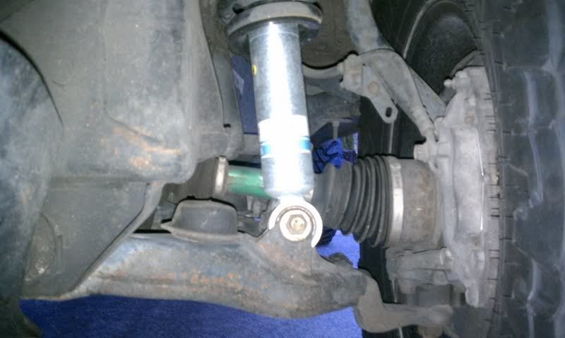

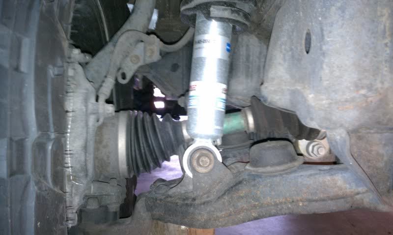

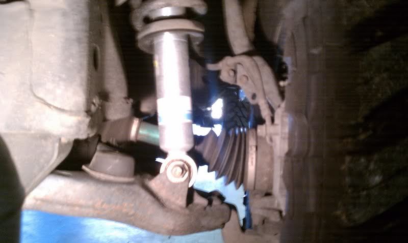

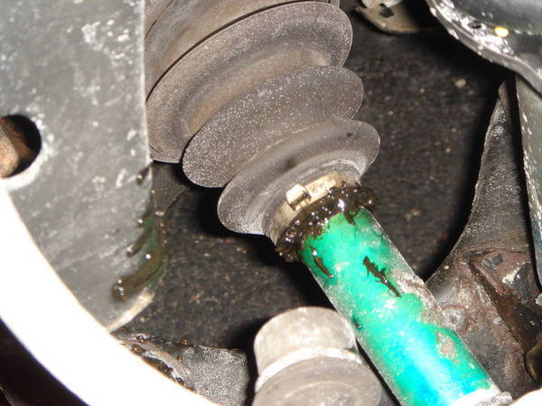

    After installing Billstein 5100's at 2.5" in the front and an AAL in the rear on my 2002 Tacoma Xtra Cab 4X4 TRD i put a good 75-100 miles on it to settle the suspension a bit before having the alignment re-done. Put new wheels and tires on, a little trimming to avoid rub ("pinch weld mod"). Having driven close to 200 miles on the new setup, I have felt no vibrations or had any problems. I had ordered a diff. drop kit from toytec along with my lift components. Just installed the kit today to keep the fins of the CV bots a bit farther from one another. The angles were not too bad, but definitely can tell a positive difference after the drop. Thought I'd share some pictures!!
    BEFORE: Driver Side
    BEFORE: Passenger Side
    AFTER: Driver Side
    AFTER: Passenger Side

    twfsa - very true, for $20 and about ten to fifteen minutes to install am more than pleased with the drop. ALSO, about the skid plate spacers that come with the toytec kit, i just threw them into my bolt bucket along with the new hardware. I installed the skids back exactly as they were before the diff. drop with the only modification being drilling new holes for the rear bolts on the rear skid plate. The rear skid, back bolts, just drilled holes in the skid and everything fits perfect. will make it much easier for down the road, every time you change the oil or drop the skids for any other work wont have to mess with the spacers and stuff.
    mjp2 - very true. just by looking at the diff. mounting style differences I came to that conclusion as well. happy i did it on the first gen though.
    Stuardoslls - downside, i believe, is generally when dealing with the second gens. kit really only lowers one side i believe and does not give as much a benefit as on the first gen.

    FYI Jason (OP) the pics your showing are the outer boots, which aren't a problem, the problematic boots are the inner boots...
    Regardless, it does look like it helped!

    rab89 - i'm well aware. just showing the change in angle in the pics. noticeable. thanks though!!

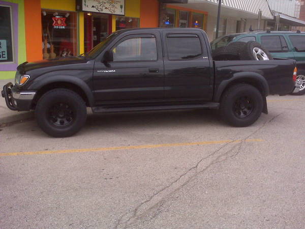

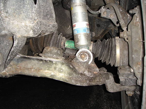

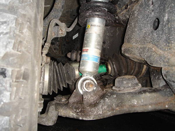

    Here it is with the new set up.
    BEFORE
    The way it sits now.
    Passenger Side CV
    Inner /Upper Boot
    Drivers Side CV
    What do you think? And yes I did install the differential drop. So I can't explain the angle. It is less then 3" (almost 2.75") of lift with 881 Coils and Bilstein at 1" (middle setting). It was confirmed today the the axle's are being replaced. This problem occured less than one week after installing the lift. Will this happen again? The mechanic at the shop didn't think that angle would cause this, he just thinks they are wore out at 123,xxx miles. Which could be true. So I will get the new axle's Sunday and get them installed and see what happens. Any thoughts would be appreciated.
