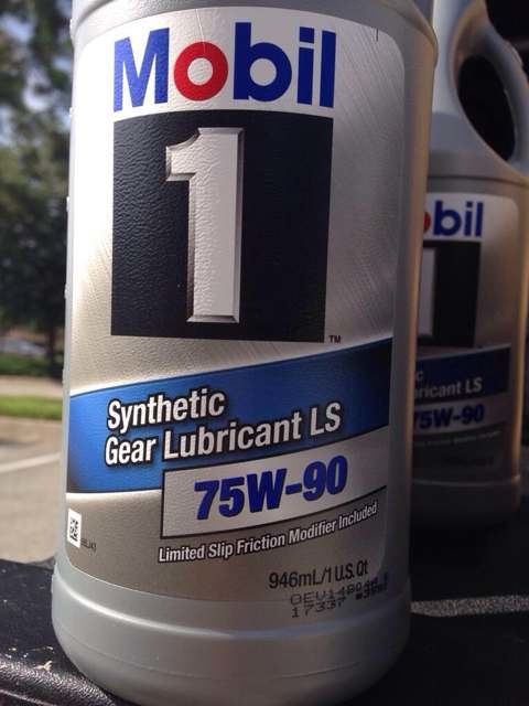

    Will this oil be good.
    Just noticed it says it has Limited slip modifier included.
    I have a 2012 with limited slip but doesn't call for the added LSD fluid.
