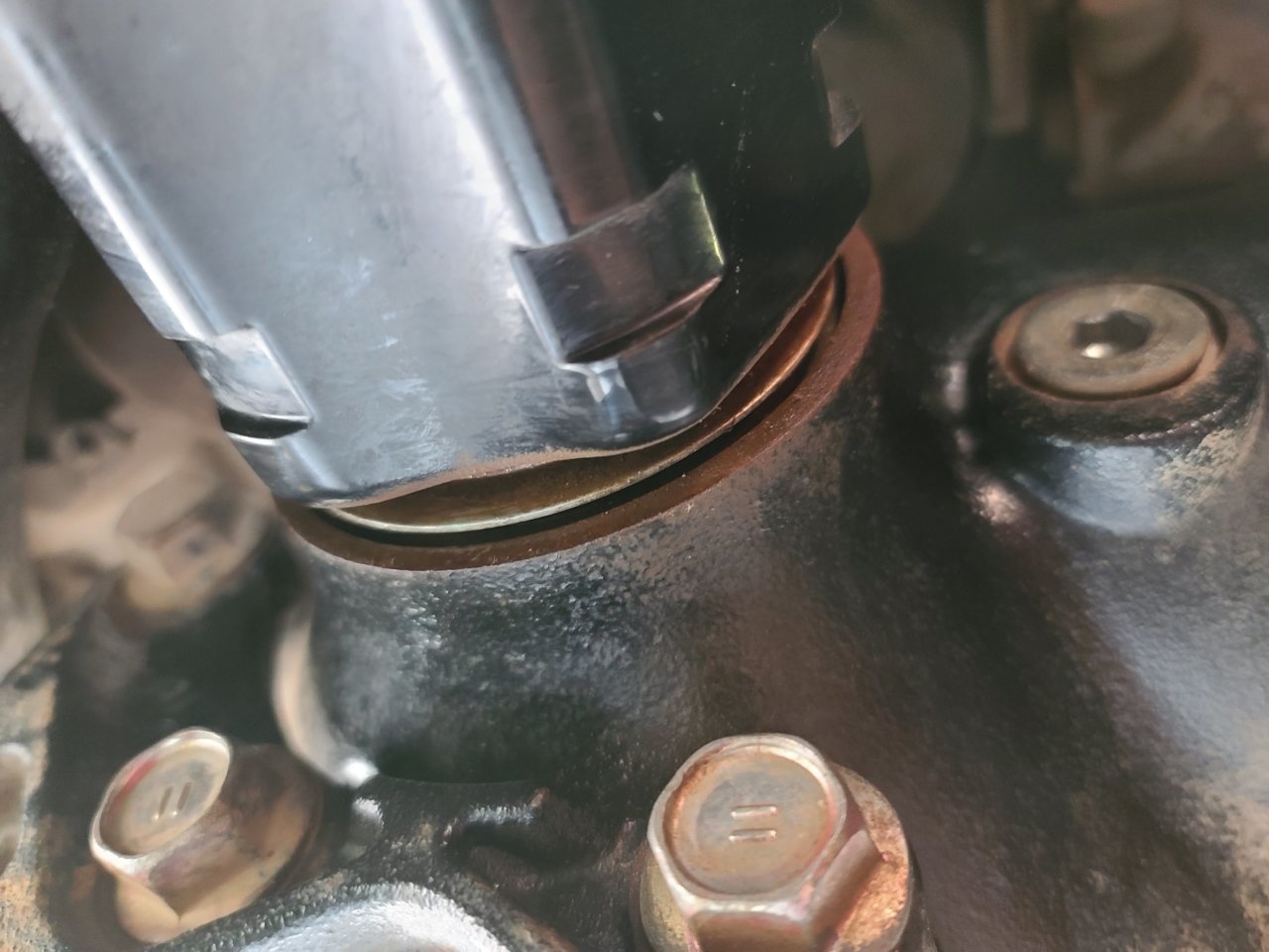

    So, who took the pics? You or the dealer?
    The CV looks to be seated. They cleaned up the diff to show no leaking oil, but the oil pan has oil on it. I'm confused.
    Edit: The frame, suspension, crossmember, and such show no splatter from a spinning CV slinging lube either. Just a weepy oil pan. Something is not right here.

    If the CV actually popped out of the diff you would have noticed a lot of gear oil under your truck or wherever you normally park it. If the seal is bad you'll notice a slow leak where the axle goes in. Something doesn't sound right but I would just keep an eye on it and see if it comes back, if the seal is truly bad you'll notice a leak there sooner than later.

    Gear oil (found in differentials and transfer case) has a very distinct smell. Are you familiar with that smell @Beast5150 ?
    If you smelled something other than that, my bet is on a sloppy engine oil change last time it was done. Judging by the pics.

    How does a CV axle come out? Is your truck lifted/leveled at all?
