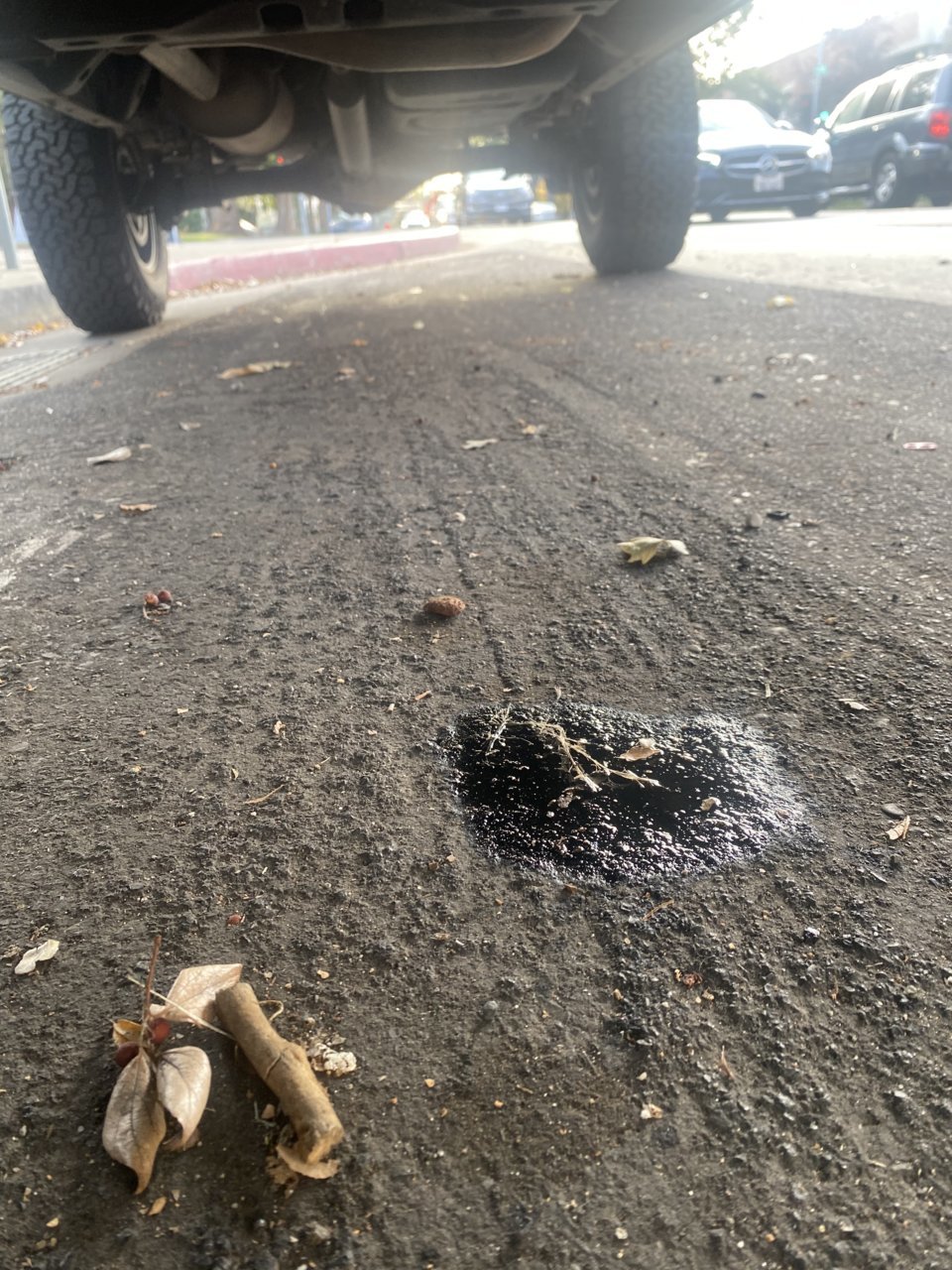

    I woke up this morning to what I believe is a front diff leak. I put new cv axles in but that was about 6 months ago and I have never had any issues. I’m assuming I just need a new gasket for my front diff? Let me know what you guys think. And thanks.

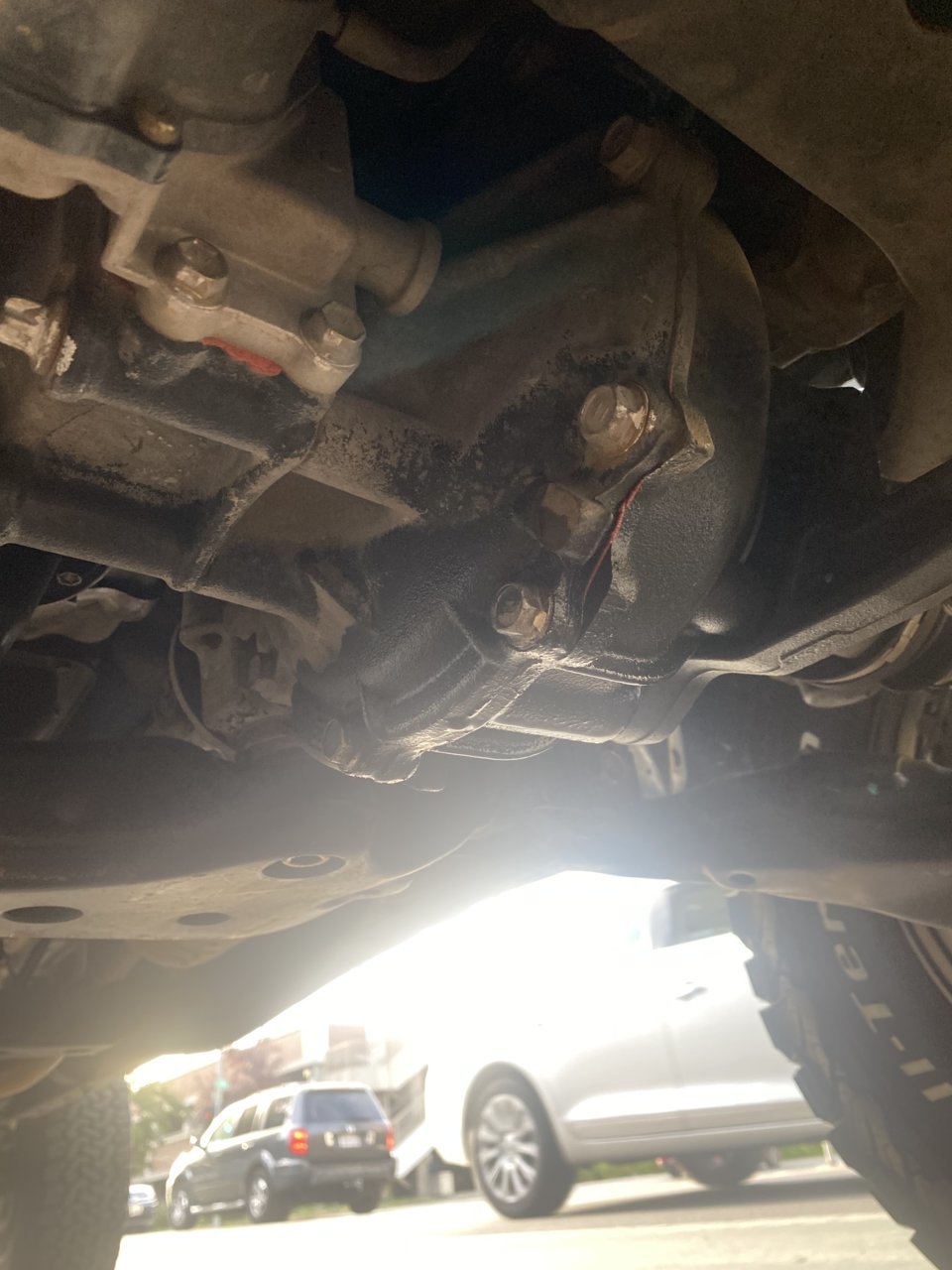

    Check the torque on the fil an drain plugs and clean it up first. Looks to me like it’s running down the diff from there.

    Just got up under and checked it. Looks like busted cv axle seal on my drivers side. Seems like it’s leaking down from there. I saw lots of YouTube videos on how to fix it so I’ll do my research.

    that is a fairly common occurrence. Especially if you just changed the axle. Those seals are finicky.

    I had to redo the axle seal on my 1st gen a few times before getting it right, if they aren't seated 110% correctly (correct depth all around, not too far in or out) they will leak. It was frustrating
