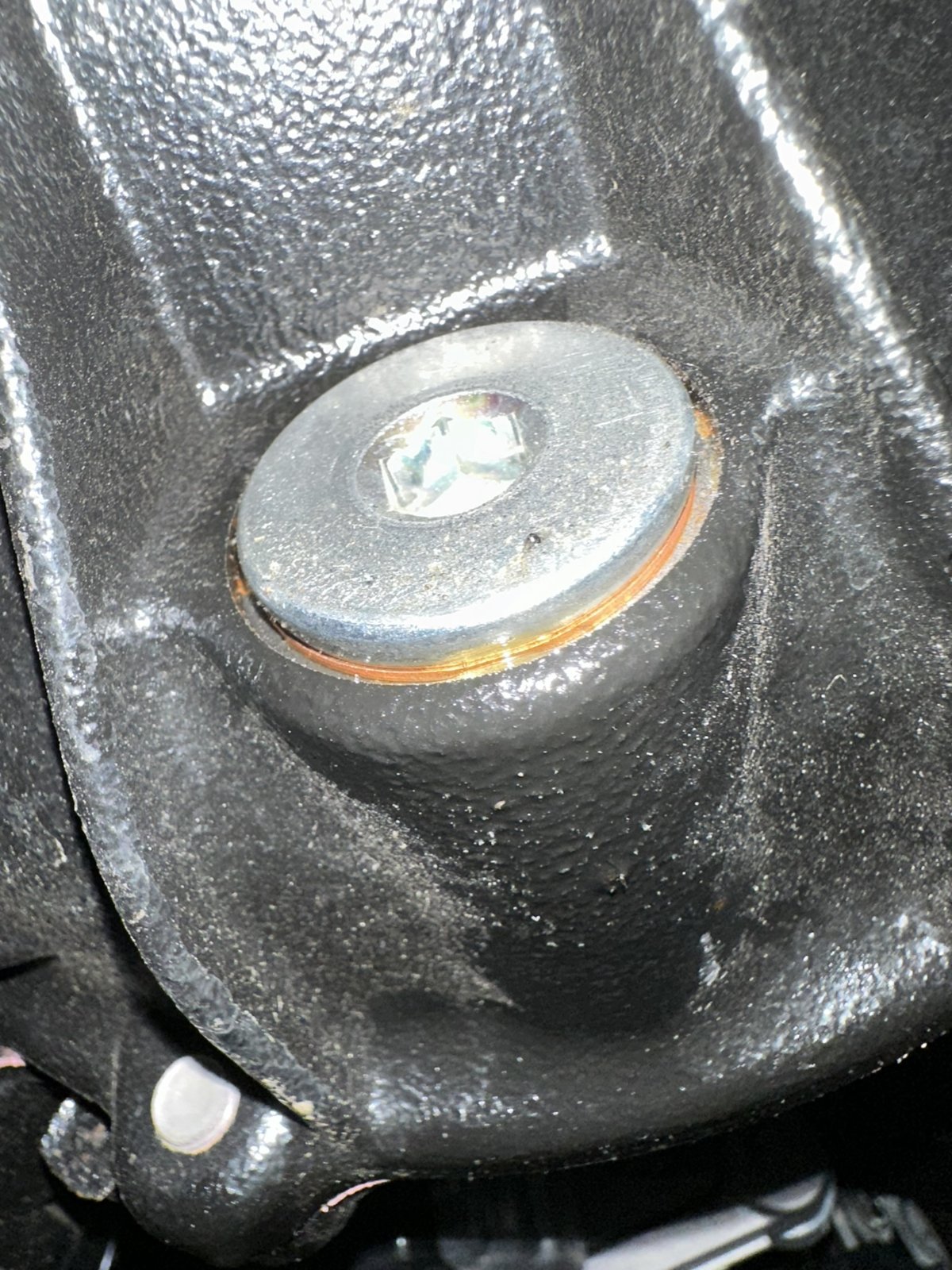

    I noticed a spot on my garage floor the other day, about the size of a baseball. Took the skid plates off the front end and noticed this coming from the front differential drain plug:
    I took it to my Toyota dealer who kept it for 2 days, insisting they couldn't find anything of concern (even after telling them exactly what to look for). The truck has 3200mi.
    Its a slow leak, most likely doing this for most of my two months of ownership.
    Eager to hear your thoughts on fixing or if this is some sort of thing that may be due to overfilling at the factory?

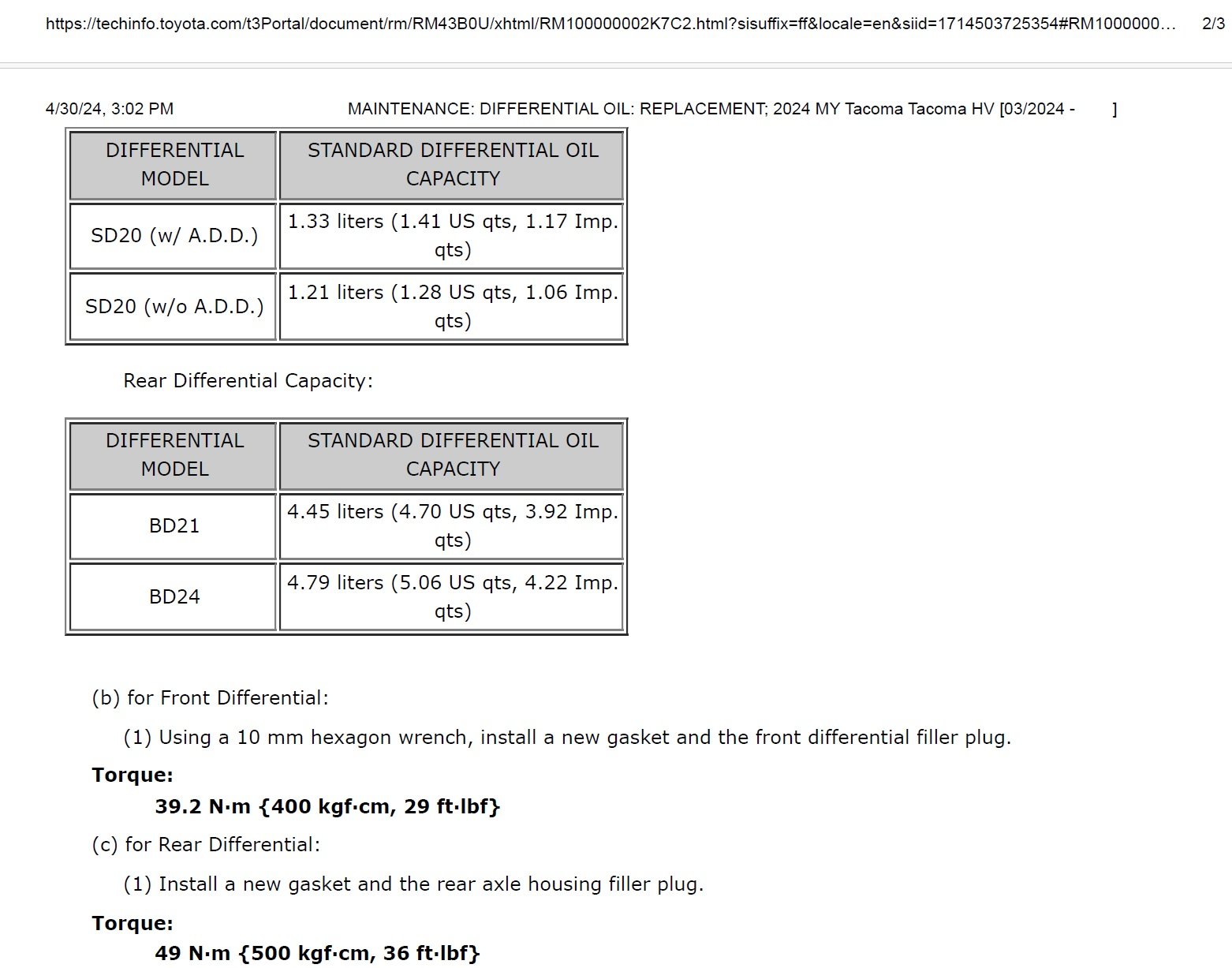

    Do you have a torque wrench?
    If so, you can tighten, wipe up any traces and reassess.

    Yeah I can get a torque wrench. The dealer yesterday said they tightened everything up and cleaned it off. I backed it into my garage instead of pulling in so I could see if I can get any drips that will be easily noticeable.

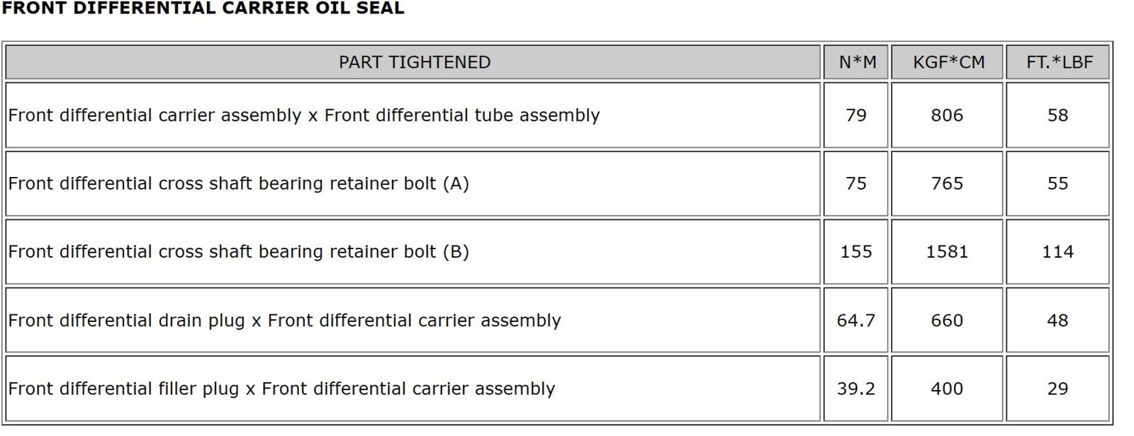

    That's for the fill plug. The drain plug is different. It's more. I forget how much more, but it's more.

    Drain is 48 ft-lb on 3G. Plug looks exactly the same along with copper washer so I'd bet it's the same on 4g. The fill torque spec is the same too.

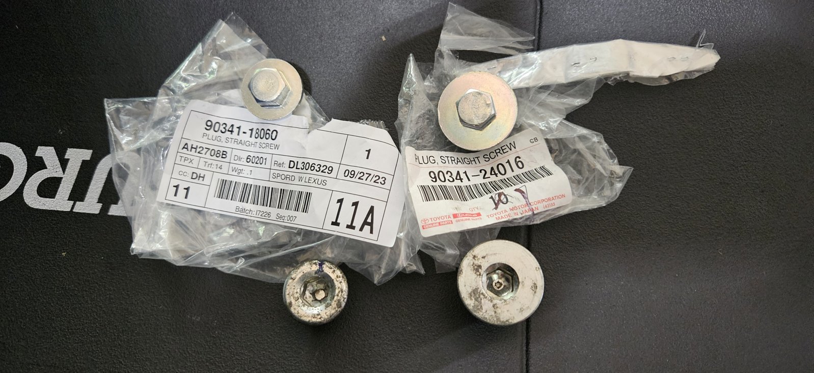

    If plugs are indeed the same, you'll want to get the Lexus replacements. I just did this on my 3g last weekend.

    Thanks. Sloppy me. OP here is the real number:

    When I did my first oil change I noticed the front diff drain plug had some oil weeping out as well. It was very minimal. I’ll monitor it and probably buy those Lexus plugs posted above. Thanks @Smacky2020

    I just bought the drain plug from https://209yota1.com/ for about $20 shipped and a diff gasket kit off Amazon.

    I used these for much cheaper and no leaks:
    Rexka 12pcs Transfer &... https://www.amazon.com/dp/B07CJHTDVV?ref=ppx_pop_mob_ap_share
    The drain washer is the large copper one. There is no back/front with it.

    Any speculation as to why Toyota still uses the hex drain and filler plug? The Lexus plugs are really a no brainer and I can’t see this as being a cost cutting measure.

    Looks like the copper washer wasn't fitted properly and caught on the lip on the housing. Yeah, that would cause a leak. That is from someone too much in a hurry to check his work.
