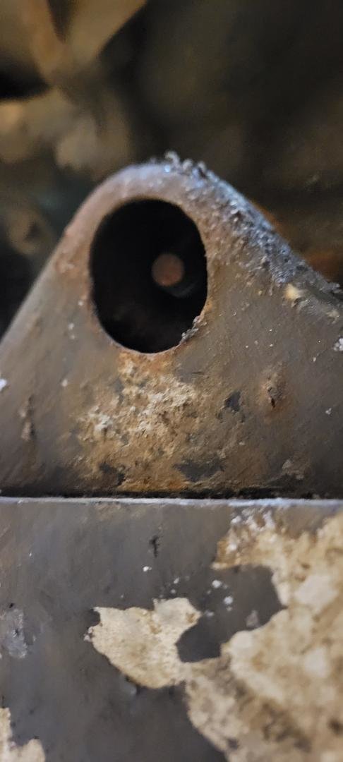

    Update. So no warranty coverage of course...just had the truck on the lift at my local mechanics place. The rear bolt where the differential mounts to the frame had pushed upward and cracked the mount. My mechanic said it looked like the bolt was loose. Probably from when the truck was built. over time with the vibration it pushed the mount upward. The noise i heard was the driveshaft rubbing on the bellhousing. The fix is going to require some cutting and welding.upload_2022-2-24_8-59-6.jpg
    The image is of the bottom of the mount. They are going to remove a piece in order to insert a plate above and weld the piece back on. Everyone may want to check that bolt to make sure its tight.
