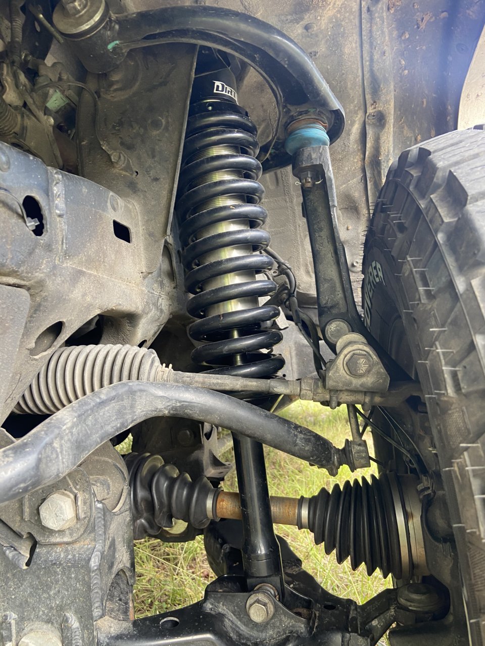

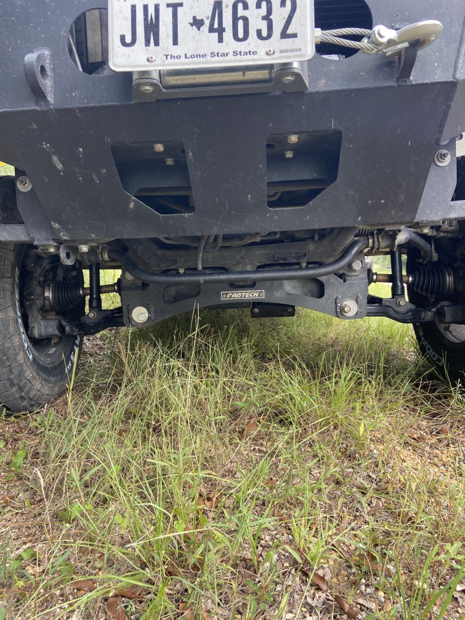

    check to make sure your cv shafts are almost straight at ride height. If your front diff is not dropped when you did the lift then cv angles are gonna be way off. Grinding noises could be your cv's and could also stretch your seals causing a leak. If you could post up pics of your front diff and your cv angles from the front it could help diagnose stuff.

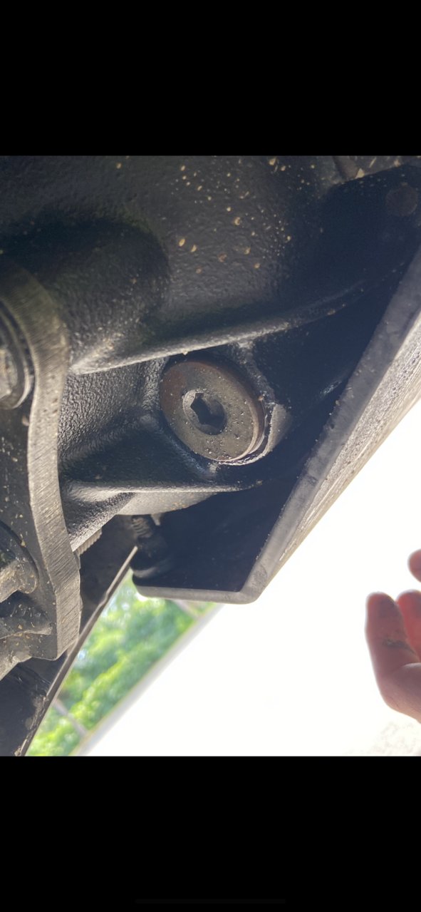

    If you look closely it almost looks like there’s a grind spot on the front diff itself, you can see a fresh grinded silver spot. WTF!?

    I wonder if there is something loose or flexing or moving and touching the diff and your hearing the vibration sound.....

    Your inner CV joint boot is out of whack. I wonder if that could make audible noise. I’ve never run 1 like that so I don’t know.

    Out of whack how so?

    You can't see that this is out of whack?
