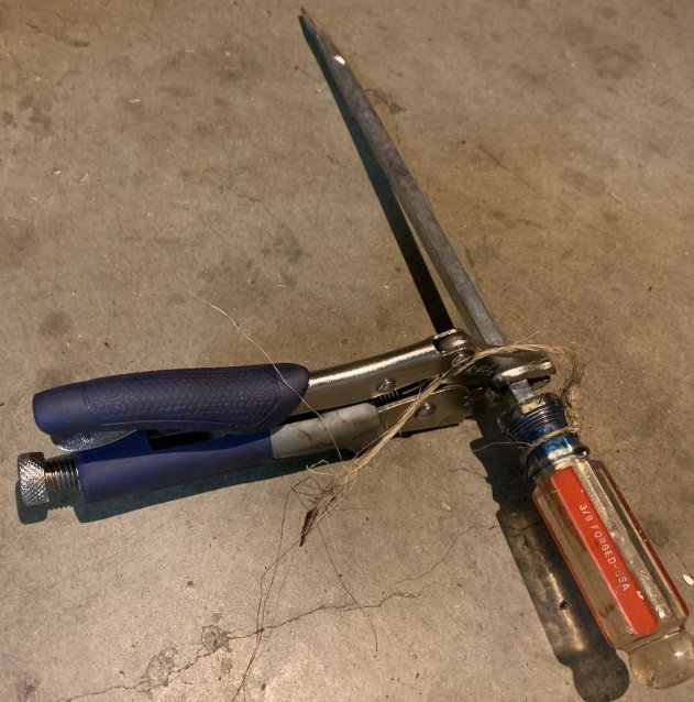

  20. Apr 13, 2020 at 7:21 PM
    #240
    dk_crew
    dk_crew Well-Known Member
    May 20, 2019
    #293798
    695
    Dave
    Austin, TX
    2005 Tacoma 4x4
    I finally got it done, but had a few hiccups (of course) along the way. 2005 double cab trd 4WD 150k miles.
    The good:
    • TW is simply an awesome place to get invaluable information to have a bit of confidence that some of this stuff is actually doable. Thanks everyone that contributes and adds thoughts about what works for you.
    • If I get the opportunity to do this again I think it's going to be fairly straightforward.
    The bad:
    • My outer boot was torn on the CV ... so I picked up the highest end napa had and will be ordering a re-boot kit for the OEM ... and either run this if it continues to work well or swap it if I'm back in there and keep the napa just in case. My passenger side is OK from what I could tell
    • My tie rod boot is also torn -- and looking at the passenger side that one is torn also ... so I'm simply continuing to add to the list of fixed ... ha!
    Confused:
    • I didn't feel like the cv was pushed in far enough to the diff, but damn it wasn't going in any further. The gap was slightly bigger than the passenger side. I wasn't sure if it was NAPA vs OEM or if I needed another 1/4". Once I put the 35mm axle nut and tightened that everything felt really good. There's still a slightly larger gap than the passenger and I wish I would have taken a before picture. I'll probably take a pic now and post it to get thoughts, but the play in the inner housing next to the diff is very very slight, not any more than before the swap, so I think I'm in good shape.
    • It was tough getting the removal tool behind the needle bearing. I guess not tougher than others. I basically pushed one end back as far as I could and used a smaller socket to whack the upper portion until it eventually got behind the bearing. I didn't think this would be that hard and thought I was having to hammer it harder than I should. Once it got behind the bearing it was a piece of cake.
    My basic steps (I think -- from memory) were ...
    1. chock the wheels and securely lift with jack stands -- I kept the passenger wheel on the ground to minimze diff oil since I had recently changed it.
    2. remove skid plate, sway bar, wheel, dust cap, axle nut, upper tie rod (loaner tie rod puller made it simple), remove 2 bolts for the lower ball joint attachment
    3. swing the brake out of the way and secure it -- it was easier for me secured up to the front
    4. pry the damn thing out -- this sucked. Ultimately, the vise grip around a long flathead (pic attached) allowed me to get the tip in and twist. Pry bars, tapping, pushing wasn't working. The damn thing wouldn't budge. I worked this around the diff at various points and it finally gave. This is the method I'd do next time and am interested to hear if anyone else does this and has success.
    5. pull the needle bearing and replace. I had it in the freezer and still felt like I had to whack the crap out of it to get it in. I put a socket over the driver handle with an extender so I could hit it from outside the LCA.
    6. Now the axle -- this wasn't too bad. It did take a bit to get started but I was able to use a pry bar and hammer against the ridges on the inside axle. I think the best was to strap the axle horizontal. Once I got it straight it went in.
    7. Reassemble and torque
