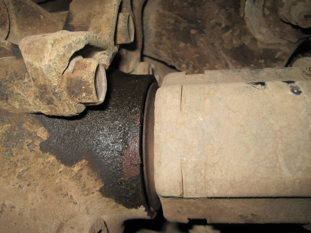

    I also replaced my driver side Diff seal, I have a few photo's somewhere. Took a few of us about 4 hours, I maybe should of replaced my axle because the seal replacement didn't fix my growl. It stopped my leaking diff, I have since had my diff replaced.

    Mike, did your leaky seal ever cause a drip to form?

    No, it was just wet.
