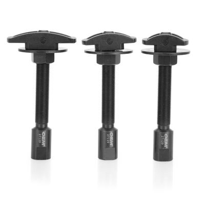

    if anyone doesn't want to make that adapter, you can rent a rear axle bearing remover to go with your slide hammer from Autozone.
    here is how it works
    http://www.youtube.com/watch?v=VIG9Sc4dhYI

    Hans, That's slick as sh-t. Almost makes ya want your bearing to go so you can use that tool.:rolleyes: Good find. Thanks for posting it.

    x2. I wonder if it has the correct size attachment? I guess maybe I need to get the bearing and take it in to my local parts store.
