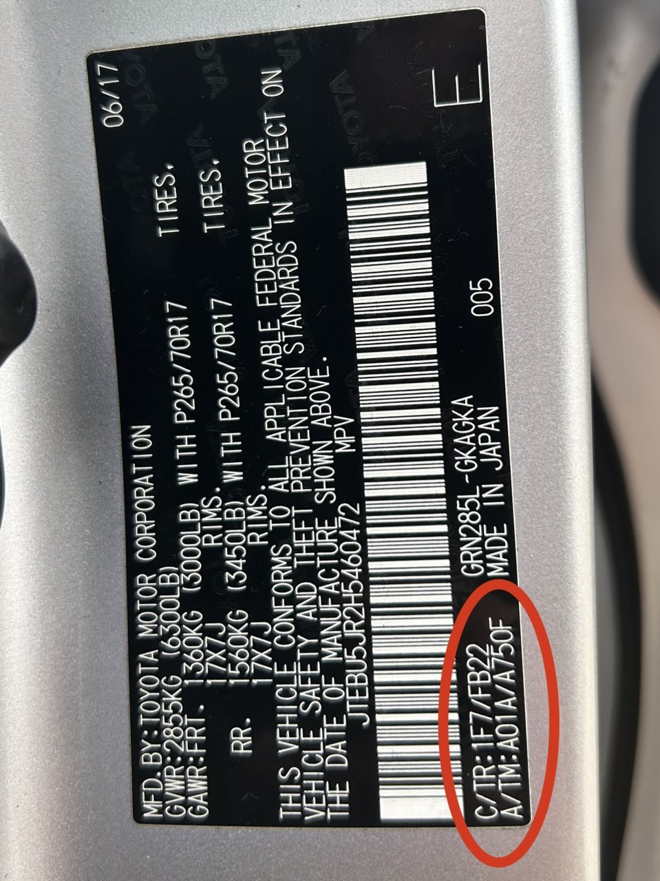

    Front diff doesn’t need any additive. For the rear, the only way to be certain is to look at you door jamb sticker and the axle code. But, no harm comes from putting additive in there even if it’s not necessary.
    https://www.tacomaworld.com/threads/2005-2016-tacoma-axle-codes.408019/
    Where it says A/TM is the axle/transmission code. In this instance, A01A. This is from my 4Runner so doesn’t match the codes above, but gives you an idea.
