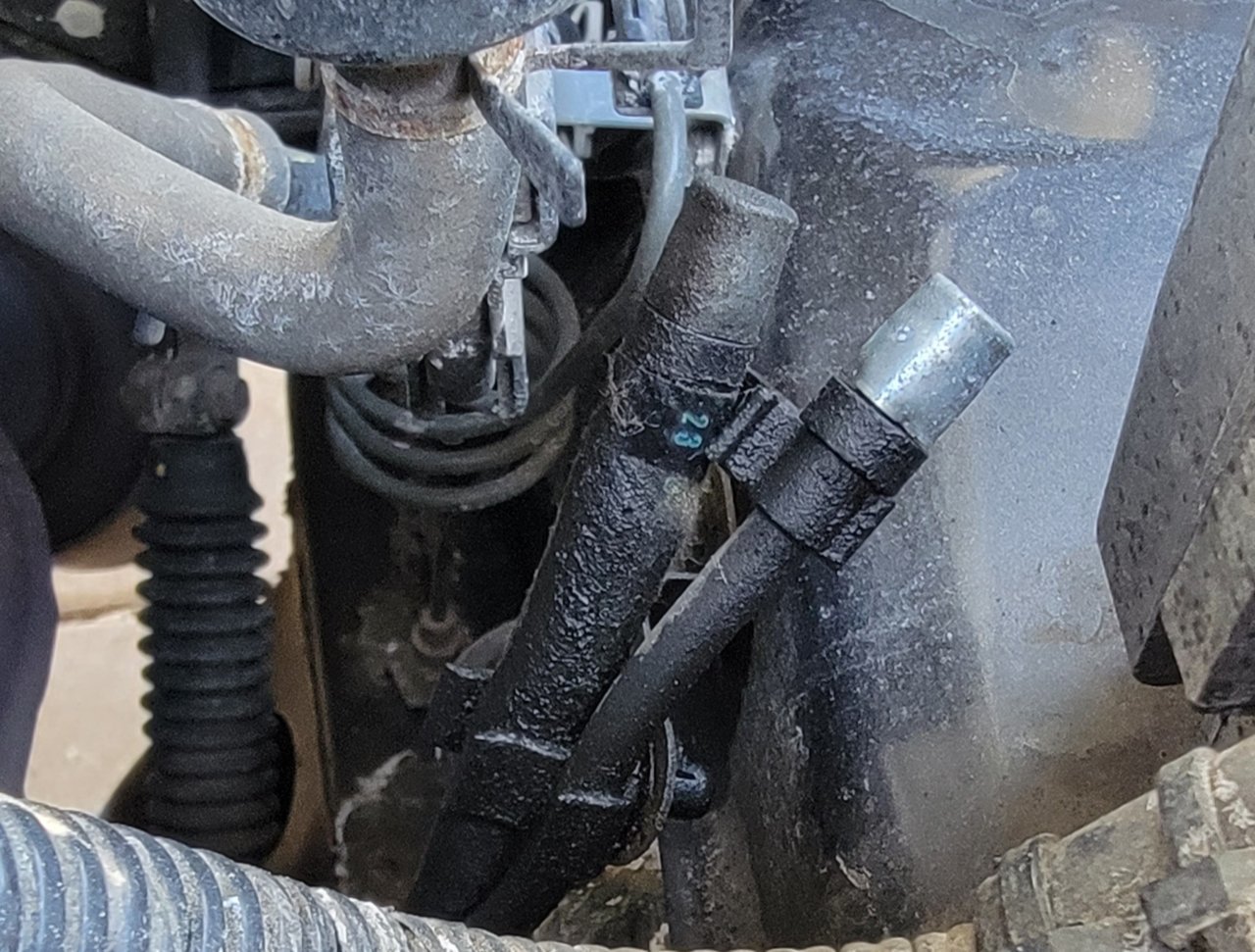

    Was doing a weekly inspection of the engine bay and noticed the front diff breather hose was very oily. It wasn't like this last week. Is this a sign of a problem or just a little too much fluid in the diff?
    I have 180k on the truck and last filled the front diff at 120k. I need to do the fluids again (I've done the diffs and transfer case every 60k) but I can't until spring when it warms up.
    Just want to make sure this isn't a warning sign of a potential problem.
