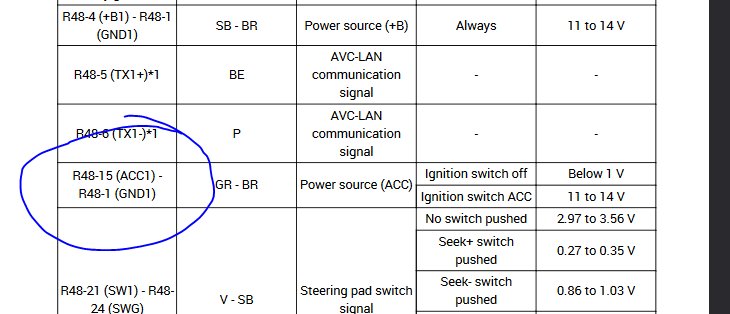

    So the 2023 NON-Jbl I believe is a clone of the Corolla 2018+
    I know that the 2020+ Non-JBL 8" entune is the one that migrated the speaker outs to a separate connector with more intuitive layout.
    This post here has the pinout as a pdf
    https://www.tacomaworld.com/threads/20-23-anytime-front-backup-camera.781376/#post-27942568
    Here is the no nav pinout
    https://www.tacomaworld.com/attachments/2021_tacoma_stereo_without_nav_pinout-pdf.5203701/

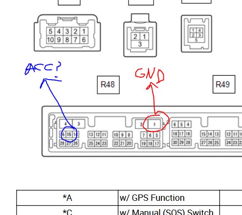

    SO with this in hand you can see R51 is the speakers...
    and R48 is the other connector on this harness...
    R48-1 is the universal ground used for nearly everything...
    R48- 15 is the ACC power that is controlled by ignition?
    LOOKING for help on this one...Reading the pin out...
    DOES this mean that this is the correct wire to tap for 12v power for the Power Pack amp...I THINK it's only on when the acc/ignition is on...
    And even so, if the amp is set to only power on with speaker voltage signal (as the Alpine power pack is) this means that the power wouldn't matter as long as it IS a fused 12v...witch is more than adequate if I read this correctly.
    Yeah...
    This is going to work...
    that Pin 15 was used for Cam power successfully...with harness cut and taps on the factory wiring.
