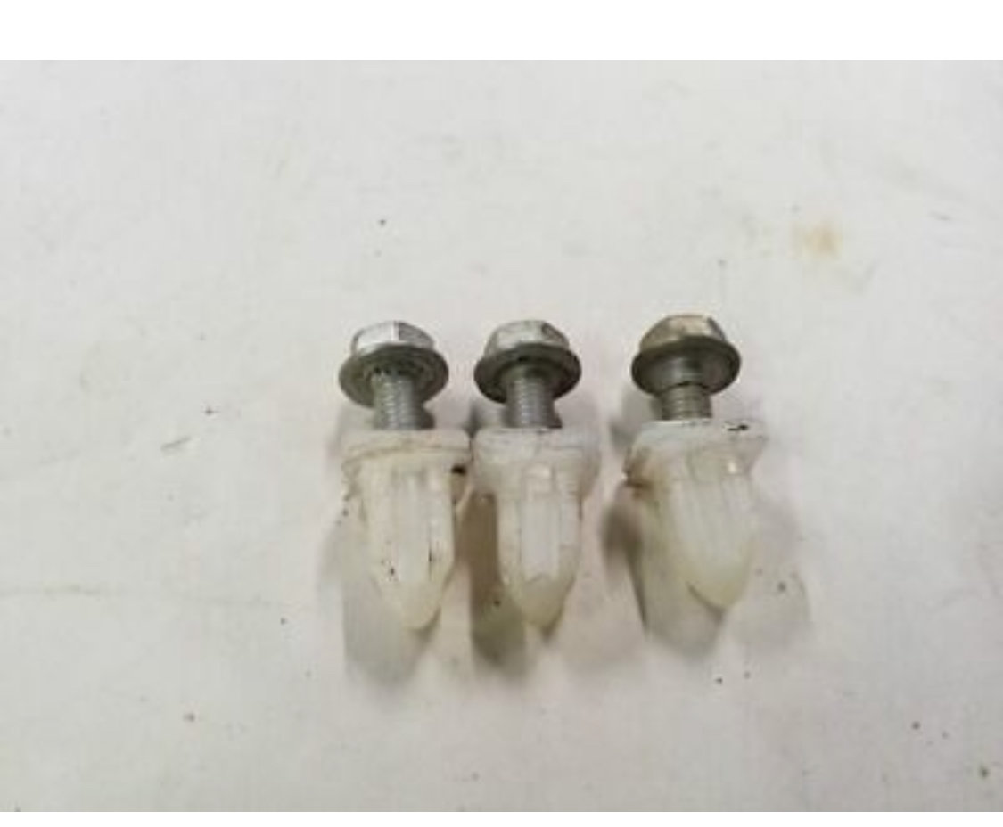

    (2006 tacoma) So only my driver-side door speaker rattles and it's because of these anchors, they're worn down inside and I guess don't grab onto the bolts as good. Does anybody know where I can purchase these anchors from or if I could supplement them with something else?IMG_1014.jpg

    I buy Toyota parts from Toyota.

    To do it easily, use a simple bolt, washer on the outside, washer nut on the inside. I have bins of these and would take very little time.
