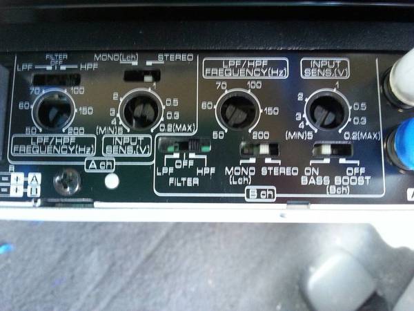

    oh no! I hope it's just a loose wire! Here are the settings right now...[​IMG]
    I'll try everyone's advice tonight and let ya know..i definitely don't have a multimeter but i can go buy one of course. And I thought the sound system would be easy to set up! :confused:

    I'm going to assume that on the amp "A ch" is the front speakers, and "B ch" is the rear speakers. First thing I notice, is that you've turned the gains all the way down on the front channels. If you look at B channel, the gain is set to 1, where on the front A channel it's all the way down to 5. Turn the A channel back up to 1, and if you want more bass, turn the LPF/HPF Frequency knob down to 70 Hz. The part of the knob that you want pointing at the setting you want is that flat part. That's the way you know it's the pointer on the knob. Try that, and get back to us.

    even if it was set to 1 it should still play some sound at a higher volume.. Have you checked if the amp is getting proper voltage?
    also a easier way to check if the speaker is working is if you take anything smaller then a 9 volt battery tapping the speaker wire -/='s and hearing a popping sound.
