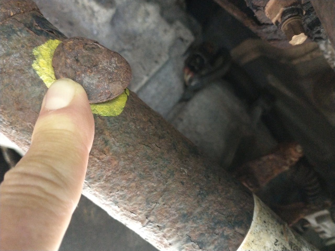

    While I was looking underneath I touched what I thought was a piece of of rust and then what looked like a weight fell off. Is this a balance weight? I noticed there is another part like this (same size) at the other end of the shaft 180 degrees opposite. What can I do about this? Can I stick this back on or get a new weight and afix it on? I see a 6 or 9 stamped on the outside. Thanks

    Sorry forgot to attach the photo.IMG_20210830_174624643_BURST000_COVER.jpg IMG_20210830_174624643_BURST000_COVER.jpg

    The front driveshaft doesn't spin unless in 4w drive right? Do they balance each driveshaft separately, meaning front and back? The driveshaft tag says it is a balanced assembly. Is it a matter of me taking the front driveshaft out and taking it to a shop to get it balanced? This is on an '05 btw.

    I have seen them fall off and never cause an issue.
    Take the truck and drive it in high 4X4 and see if you have any vibration. No Vibes = No worries.
    The same applies to those little balance weights on the brake drums.
