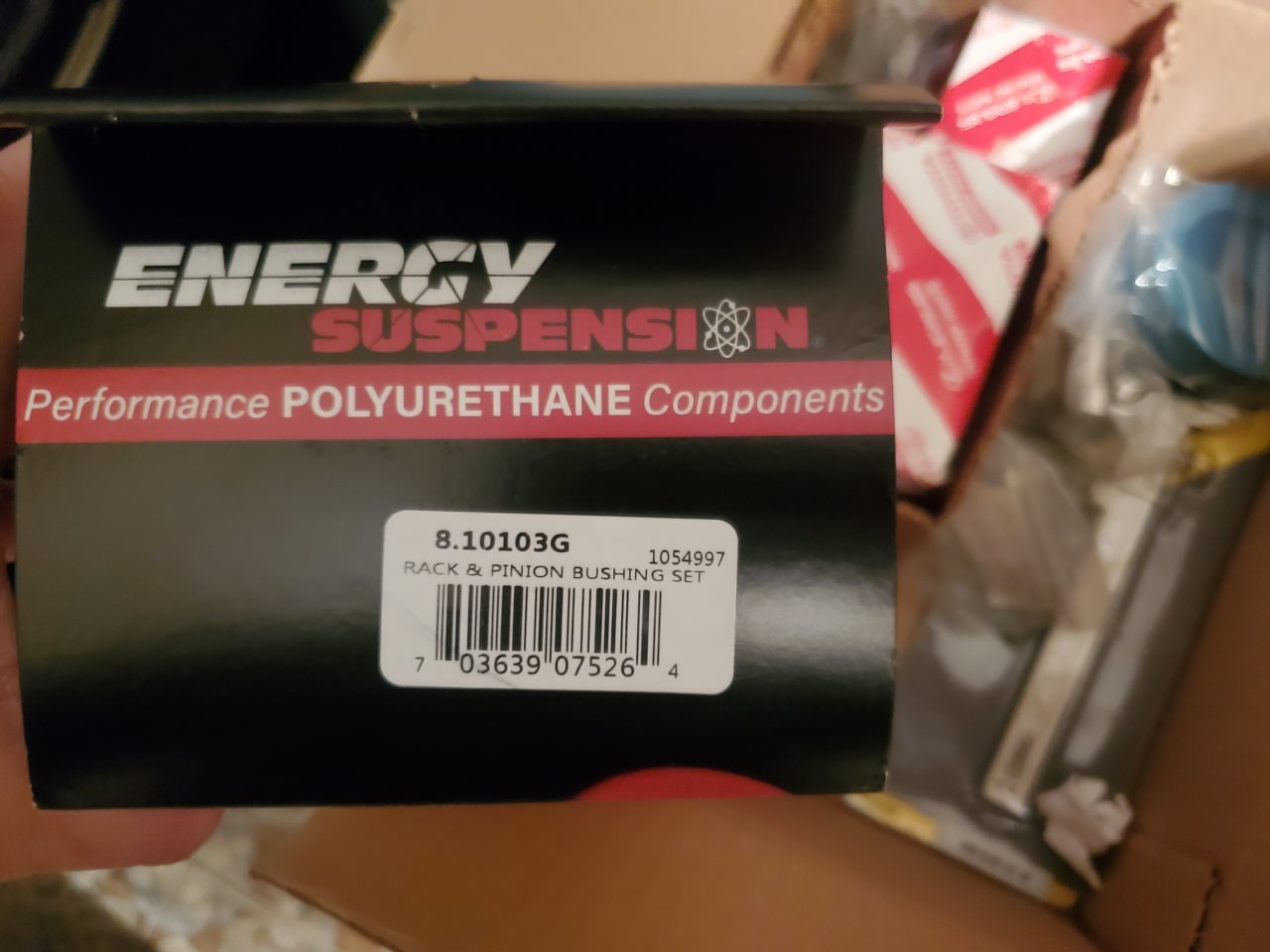

    I need to do mine as well and bought Energy's offerings. They have a Red and Black version, with the black version being slightly firmer.

    I've had Energy Suspension Poly bushings on my steering rack for 16 years or so (two sets, replaced them this year) and they have never made a sound. There is very little movement in the steering rack compared to leaf springs or control arms. Those tend to get a little loud from time-to-time, but I can say that I haven't heard a thing from the Whiteine LCA bushings, or the ES poly upper bushings in the year they have been on the truck.

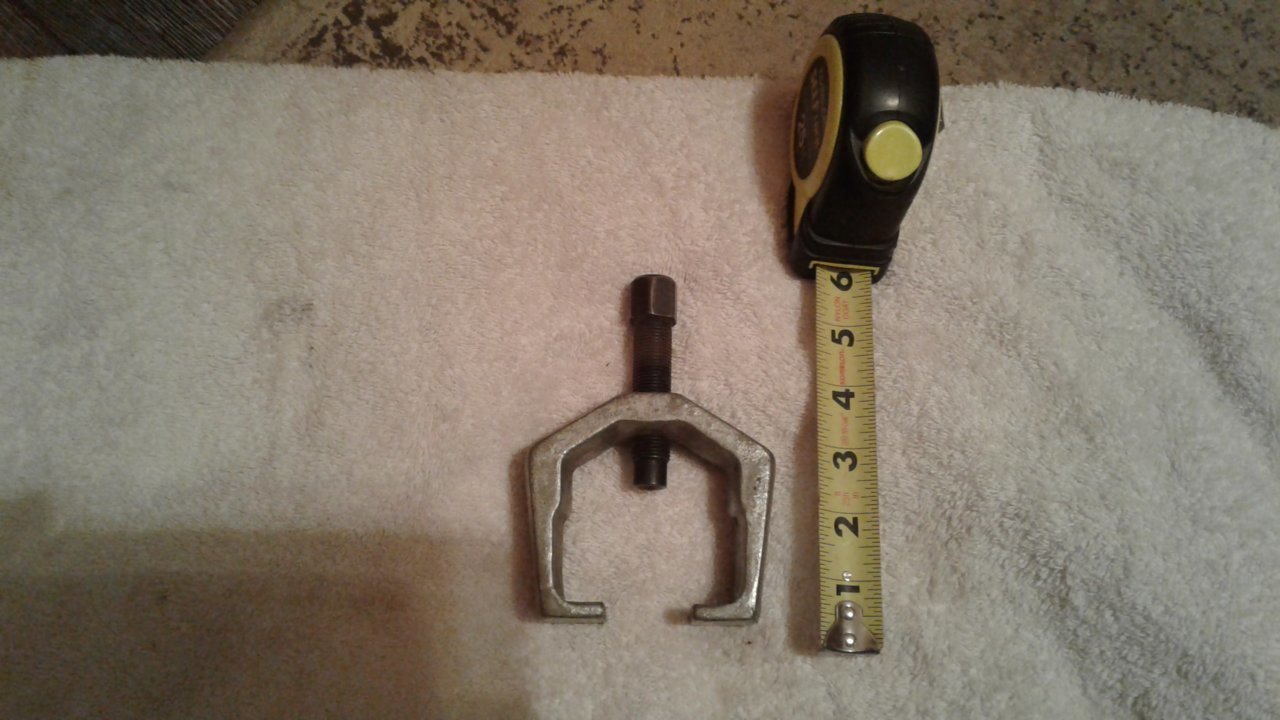

    Would this puller work for the lower ball joint and/or outer tie rod end?
    Bushings arrived yesterday (one business day from ordering, thanks Whiteline!). Waiting on lower ball joints and Prothane Super Grease.

    Yes.
    Careful not to pinch and tear the boot on your TRE.

    I tried that tool when I needed to remove the outer TRE but I couldn't get it to fit squarely on the bolt. Couldn't get the shield behind the brake to move enough, and the bolt in the tool wouldn't go completely over the top of the bolt in the TRE.
