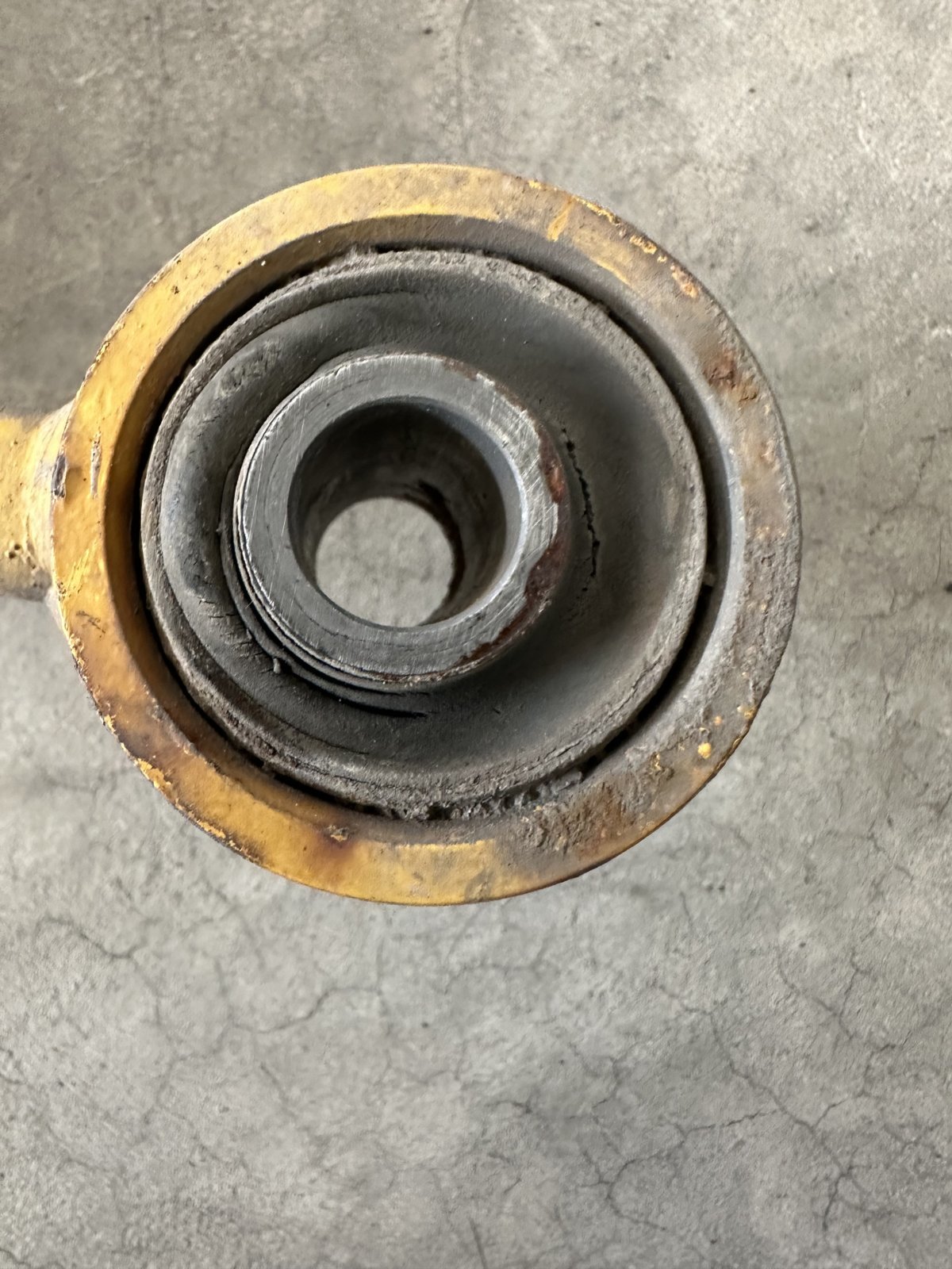

    Could be your strut bushings. I had a clunk going out of my driveway and the lower front bushings were done for. New shocks and the noise is gone.
  9. Jan 29, 2024 at 10:38 PM
    chasecmc
    chasecmc Well-Known Member
    Aug 17, 2023
    #431497
    219
    Chase
    2017 DCSB TRD OR
    GFC Bilstein 6112/5160 Icon RXT Rock Sliders
    Gunshot-6A likes this.

    I heard a metallic clinking recently from my front end also. Speed bumps, sharp turns, or accelerating just like you described. I thought it could've been bushings, body mounts, loose part hanging down, etc - sounded metal on metal.
    I was stopped at a red light on a windy day and heard it. Turned out to be the flimsy front wheel-well fabric liners. It had come loose and the plastic body fastener still attached to the fabric was ramming into metal when it flapped.
    Sounds dumb, but worth a check maybe. Drove me crazy for weeks and it was the most minor thing ever.
