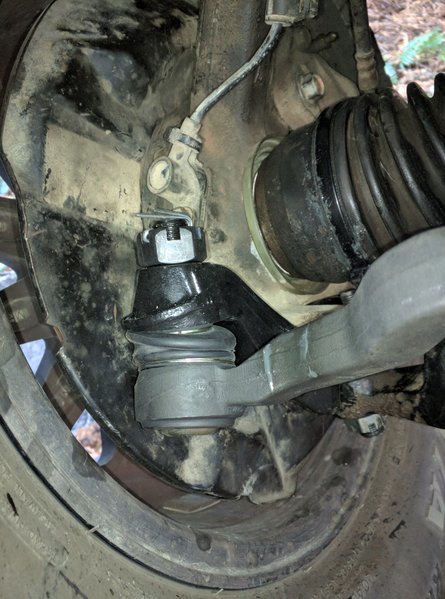

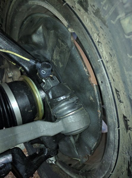

    Got my truck back from the shop on Tuesday. New steering rack, lbj's, CV,s, tie rods, passenger LCA and spindle...and camburg uca's and kings. I Had a ball joint failure a month ago. Driving to work on Wednesday morning I noticed a slight clunk sound whenever my driver side tire hit a bump. Even the small holes in the center line of the road would cause the clunk.
    I crawled under the truck once I got to work and noticed the driver side tie rod looks as if it's rotated forwards. Whereas the passenger side sits level. The boot is an easy indicator of this.
    Is this normal? Could this be causing the clunk and squirly feeling on road? I won't have access to my tools until Sunday when I get off shift. Also, only 5 lug nuts installed on my passenger side. Smh.

    Grab the tie rod and you can rotate it. You'll see what I mean.
    Not likely causing your clunk
    Check your sway bar end links

    Sorry old post... But I just noticed your drivers side cv is missing the dust shield at your spindle hub. Hopefully you've noticed it by now...
