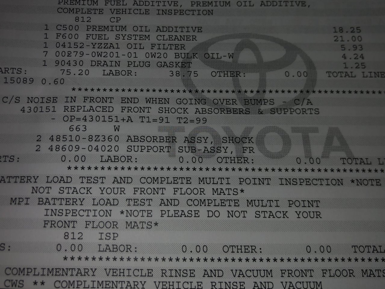

    Hey all so back in April the dealer said they were going to replace my front shocks but didn’t. Long story short, the finally did replace them on Thursday and the noise has finally went away! Here’s a shot of the parts they ordered that fixed it for anyone’s info.

    I had a clunking sound, almost like when you drive over a metal manhole cover....like a metallic clacking, almost everytime I went over a speedbump or into a driveway. They replaced the front shocks and it went away. So anyone who has any kind of clunking, try to get them to replace them!
