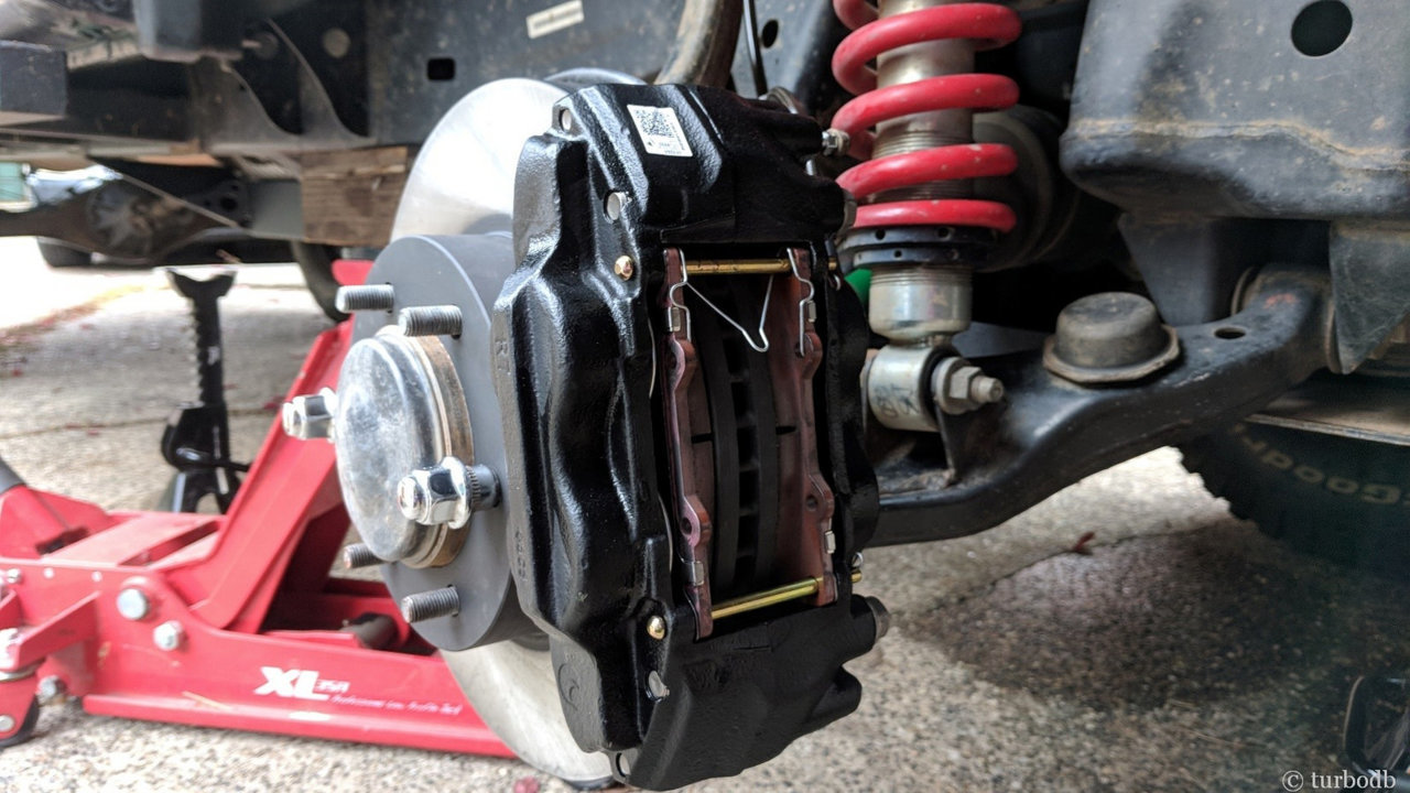

    Brake slap, clunk call it what you want. The rattle clip is off. Mine came off twice! Take wheel off and look down. You'll see "W" shaped clip out of its hole(s) in the pad. Put it back in and it will stay until you brake really hard. I'm replacing mine with a new clip as it came off today again! Clunk, Slap, muffled rattle. And yes it WILL hurt things as your pad(s) on that side will wear uneven. Let me try to post a picture I found online of this clip - see that clip on top of the caliper? Look at yours - you'll see at least one side out of place.

    Same here did fresh pads and rattle clips, noise is gone. Are those OEM pins they dont look like it

    Hi. Actually I "borrowed" that picture from another (Tundra) thread - maybe, maybe not OEM. The darn things are popping out of place on everyone, though.Also, in the Northeast (Syracuse, NY) ice build up when it's persistently snowing and too cold too melt will cause a clunking sound in the brakes as well . . .
