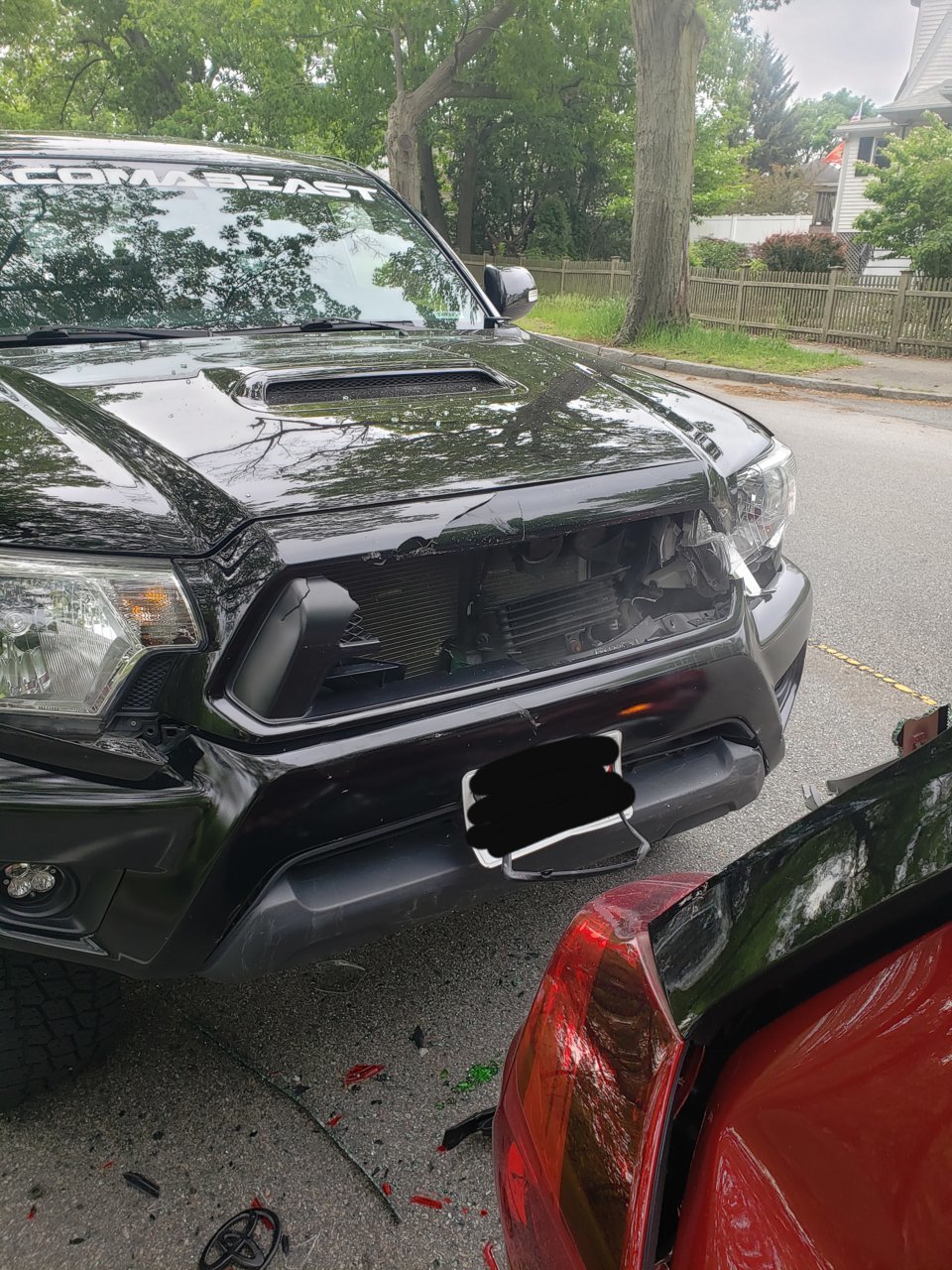

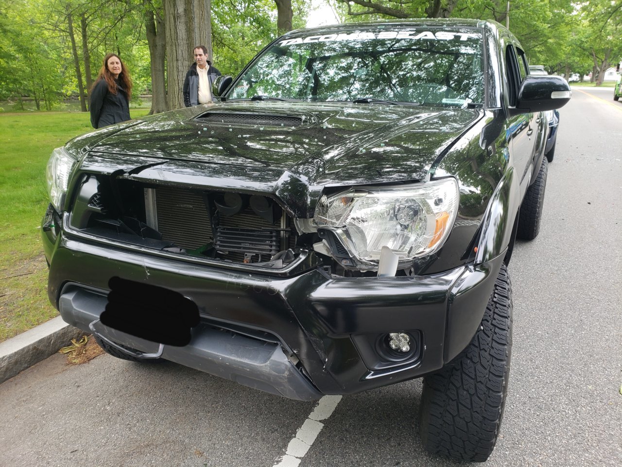

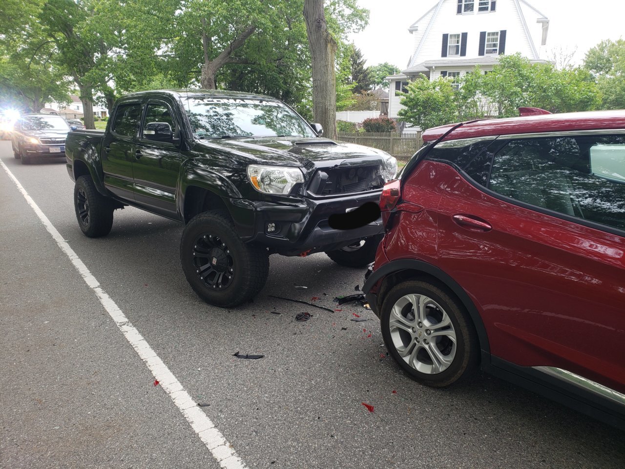

    Hey there guys, pretty bummed that this is my first post on this page, but here we are. Got into a pretty bad accident this morning as some people screeched to a stop for a cross walk. Of course I was looking down to make sure my yeti wasn't taking the rubber cup holder with it as it always does. Ended up hitting the chevy in front of me pretty good, puncturing my radiator , and mangling some internals. Needless to say, I know this one was my fault, just glad no one was injured. Still bummed as I've only had her since last Christmas, my insurance should cover it, just hope she gets back to me soon, driving an outback for the meantime. I guess I'm just looking for some feedback and suggestions. Happy trails everyone.

    Looks like you got the AC condenser and not the radiator. I don't see a big puddle of water underneath the truck. Doesn't look horrible. If you have collision and they pay you enough get an aftermarket front bumper. Doesn't look too bad because the hood and fenders don't look totally shifted out of place. Maybe just a little radiator support work on the DS and replace some of the brackets and stuff.

    Thanks for that man, appreciate the info. Some green fluid was leaking out right after the crash.

    Yeah I see some of it in one of the pics it's just the dye that's in the A/C system for finding leaks.
