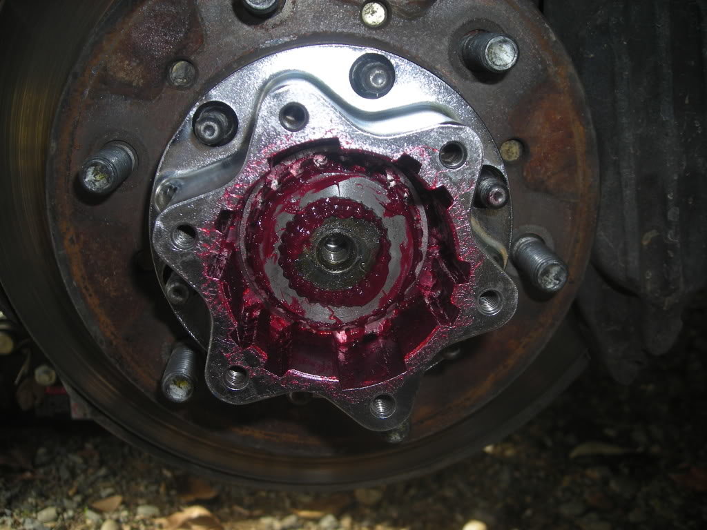

    not at home so I can't take a picture of the actual truck, but this is what I'm talking about. only difference is I didn't take the bolt out, and the bolt is completely tight. the CV axle wiggles inside the hub.

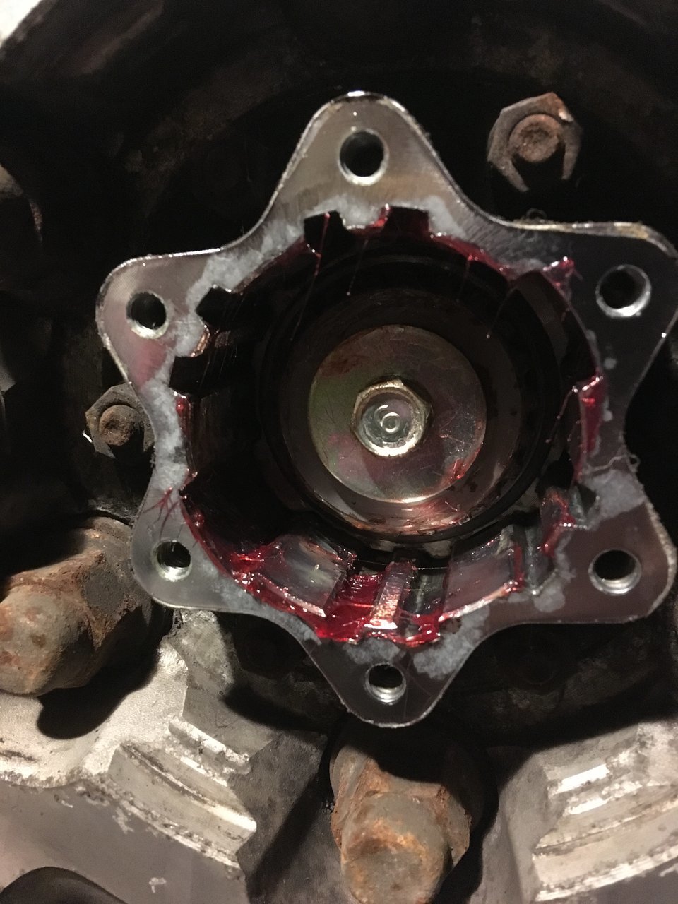

    okay, here's what mine looks like. the entire assembly inside the locking hub wobbles a little, and when I turn the CV axle with a ratchet (wheel on the ground) it makes the grinding noise every once in a while.

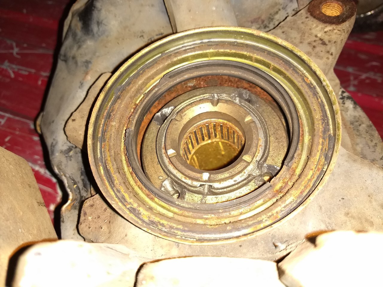

    It's the hub needle bearings. Easy enough job. $12 part.
    Just rent a blind hole puller from AutoZone. Pull the inside bronze bushing out. Be careful, they're not sold individually.
    Pull the needle bearing. Replace. Tip: freeze the bearing and bushing in a freezer for a few hours and heat the hub mildlybwith a torch before tapping in with a socket and use a rubber mallet on the bushing.
    After time the bronze bushings break down and ruin the bearing.

    They're needle bearings and are known to seize when the outer seal fails, they rust to the CV shaft. I have one in my garage I'll take a pic of in a minute
