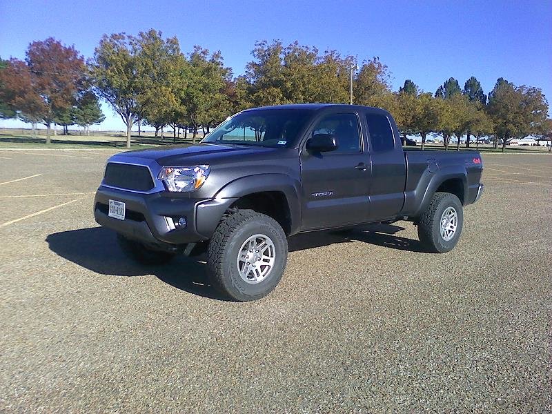

    2222222222222222222222222222222222.jpg Well here is mine with 11,000 miles on it to show you the amount of lift, and how high it is with a 3" high lift, with 265's on it. Mine makes the noise, not all the time, and sometimes loud, and sometimes quietly. Well today it was loud, so I went to the Toyota house and told them what was going on, gave them a copy of the Toyota Service Bulletin, and carried them for a ride. Showed him the noise, and showed him with 4x4 engage and no noise, then not engaged and the noises return . When we got back to the shop he said it would probable be Wednesday before the parts came in, wrote down the part numbers off of the paper work I gave him, and handed me my paper work back to me. Then told me they were sorry for the problems, and they would fix it.

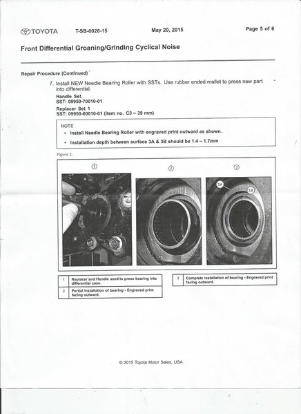

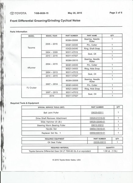

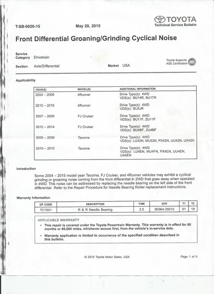

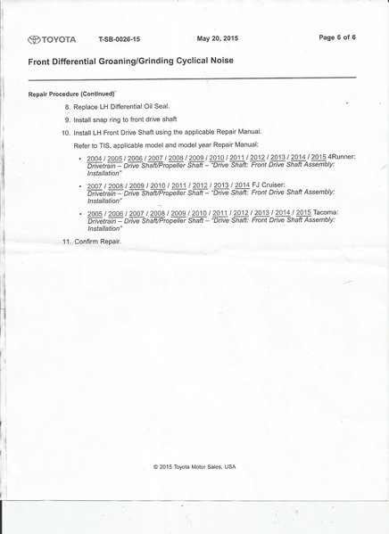

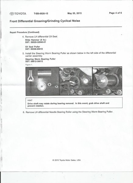

  5. Dec 19, 2015 at 6:51 PM
    #165
    jdg
    jdg Well-Known Member
    Jul 19, 2015
    #159846
    399
    David
    Texas Panhandle
    2015 Tacoma SR5, V6, automatic, 4x4, extended cab
    All the time!!!

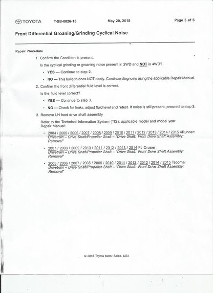

    Well here you go, Lots of Luck!!! Let me know how it goes.
    Scan0007.jpg Scan0008.jpg Scan0009.jpg Scan0010.jpg Scan0011.jpg Scan0012.jpg

    Well just for what its worth, I carried it in and they changed out the bearings, sense then there is no vibration, are noise at all.

    Took my truck in last week to the Dealership and told them about the issue. I showed them the above Service Bulletin. They ordered the parts and scheduled the work for today. I just picked it up and all is good. They covered it all under warranty. Hope it doesn't come back.
