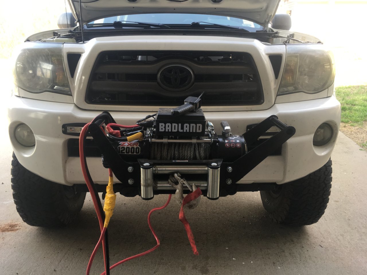

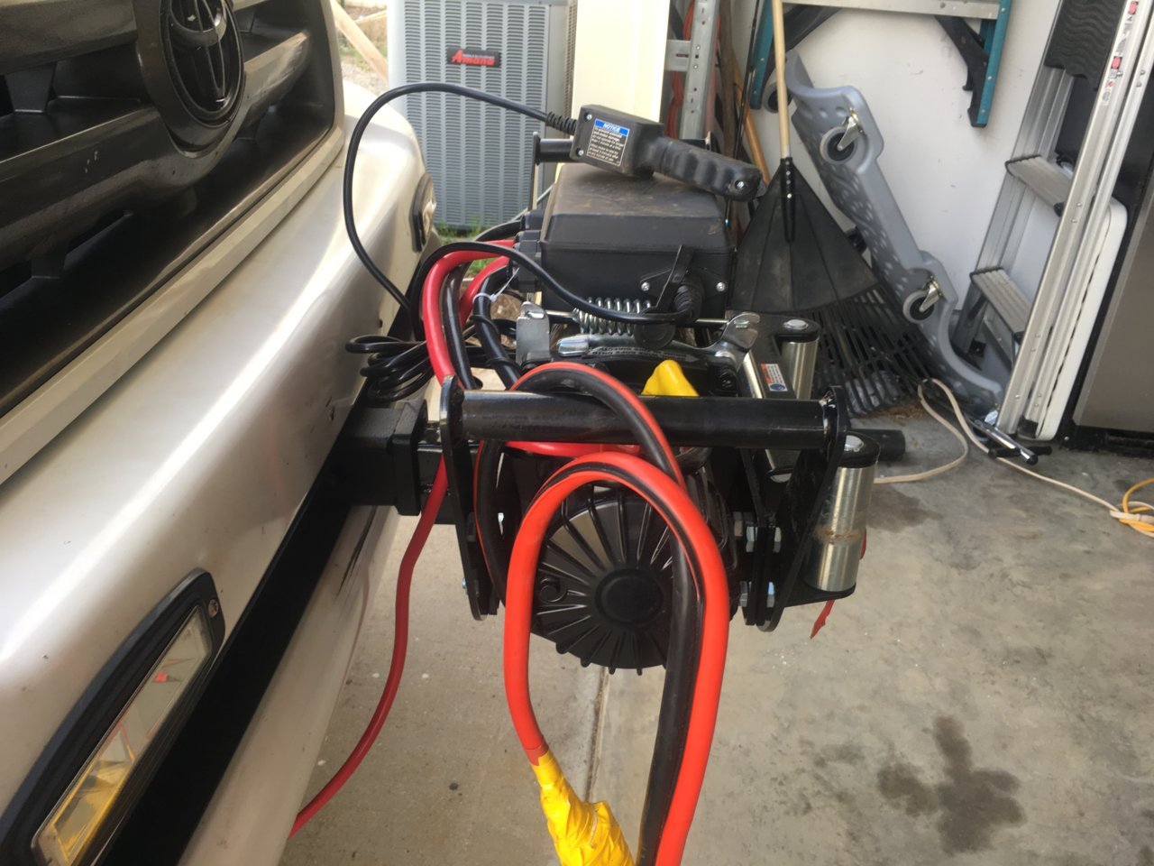

    I'm going to run some 1 gauge cable to the back. I just bought this and will be mounting it soon: https://www.amazon.com/gp/product/B01GU4O3GG/ref=ox_sc_act_title_1?smid=A3NZBJP047W6G0&psc=1 The reviews have people using it to run 12k lbs winches with no problems.
    I'm going to get a BadLands 9k lbs winch from Harbor. That's plenty of pulling power to meet the need of my truck (5.5k lbs x 1.5 = 7500ish). I have had a lot of people saying they have never had an issue with it and give it the thumbs up for the hobbyist.

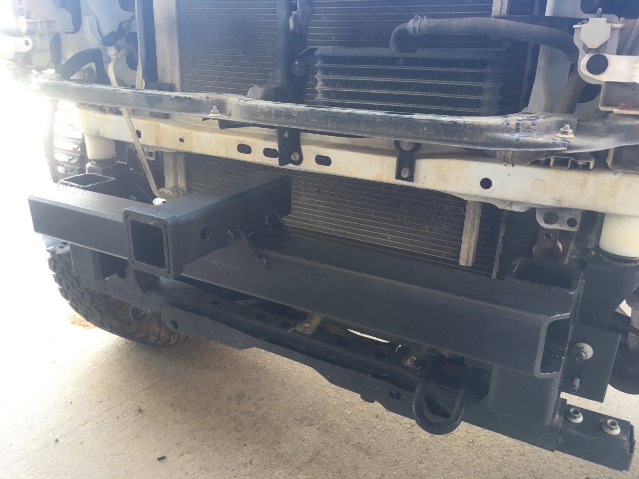

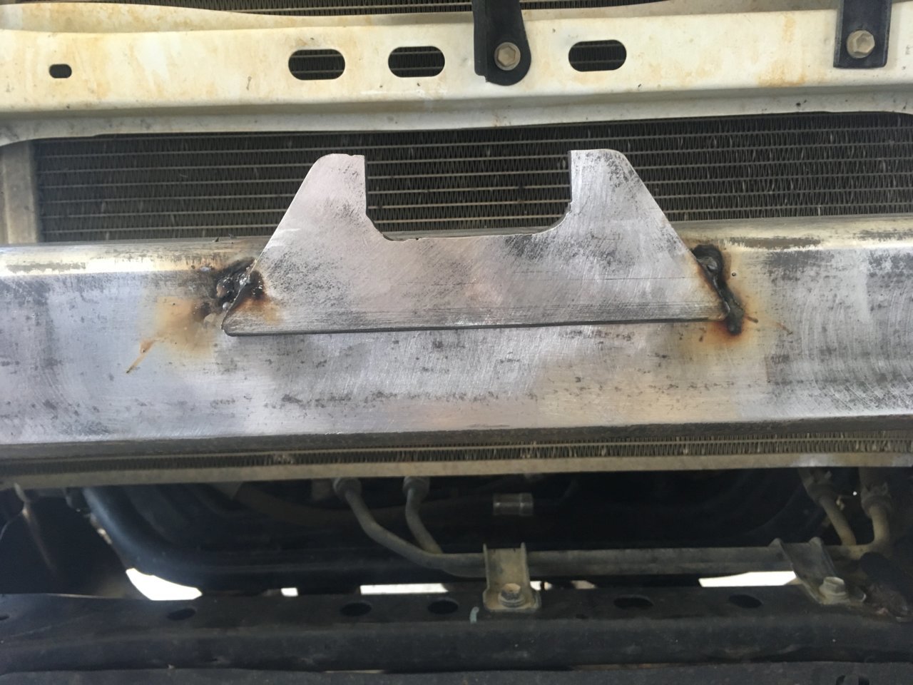

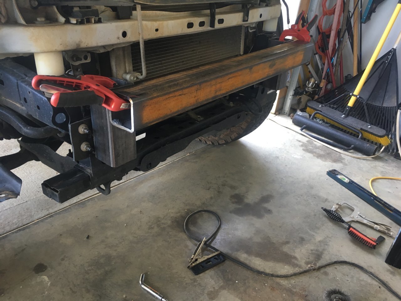

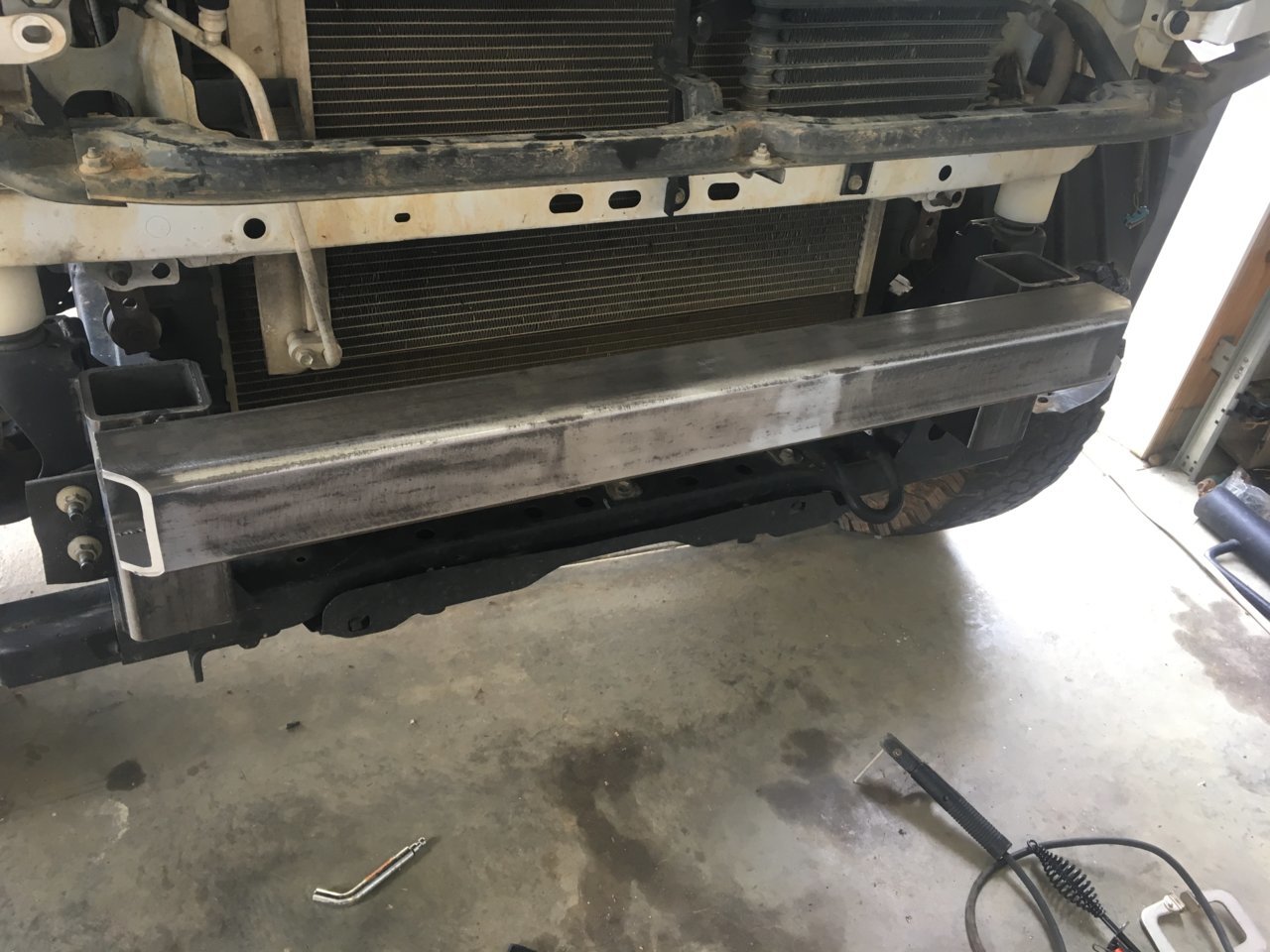

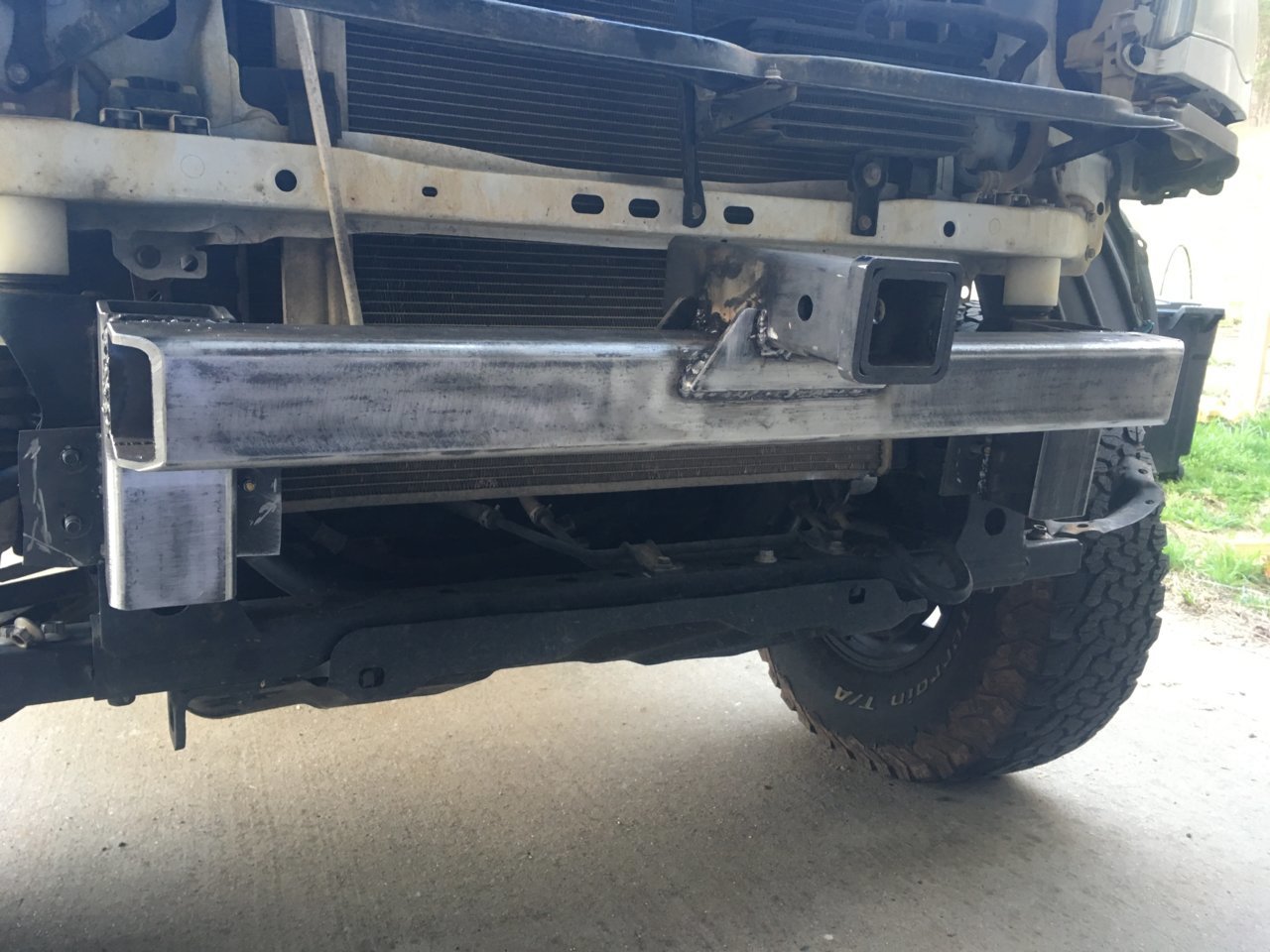

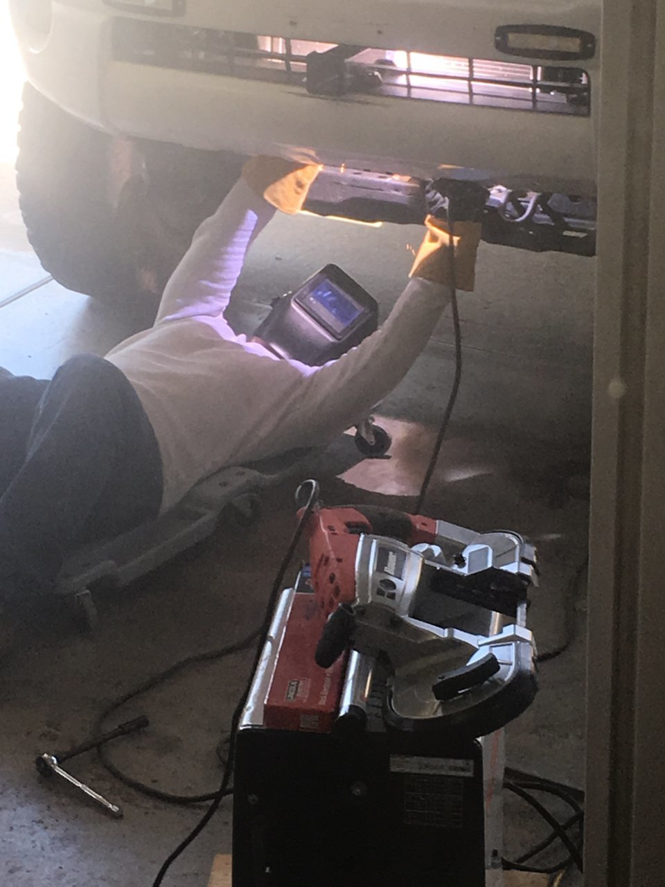

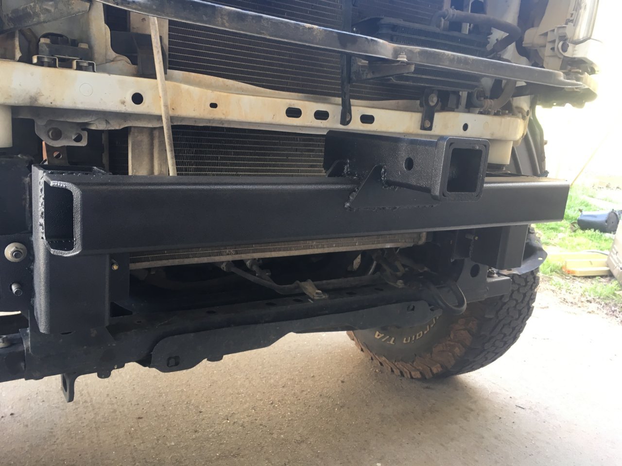

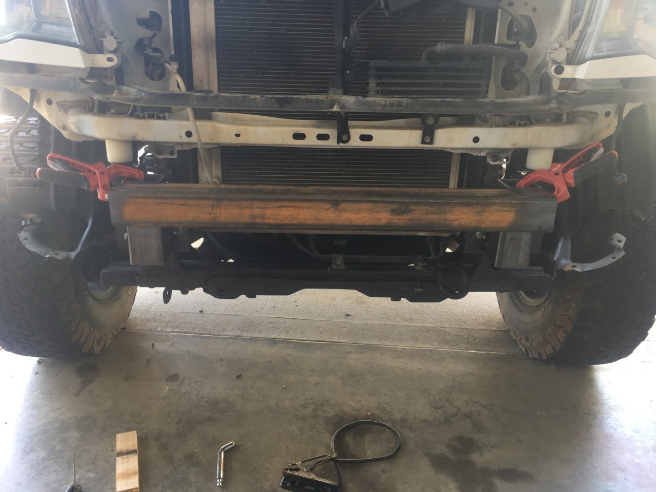

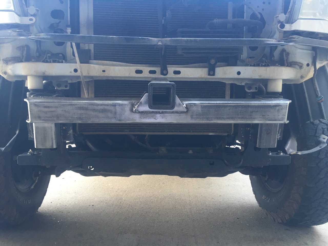

    Okay, so I've been kicking around the idea of making my own front hitch for my truck. Places were willing to charge upwards of $500 just for the hitch mount and did not include shipping. So after some researching and rough design work (and being stuck at home for so long due to the virus) I went to work.
    It took me about 8 hours total to build with the tools I had. Feel free to knock my weld job. I know I suck. This was my first actual weld project. lol But I love doing it and I think it turned out great. Especially after I painted it and hid the welding splatter. Hah Hah

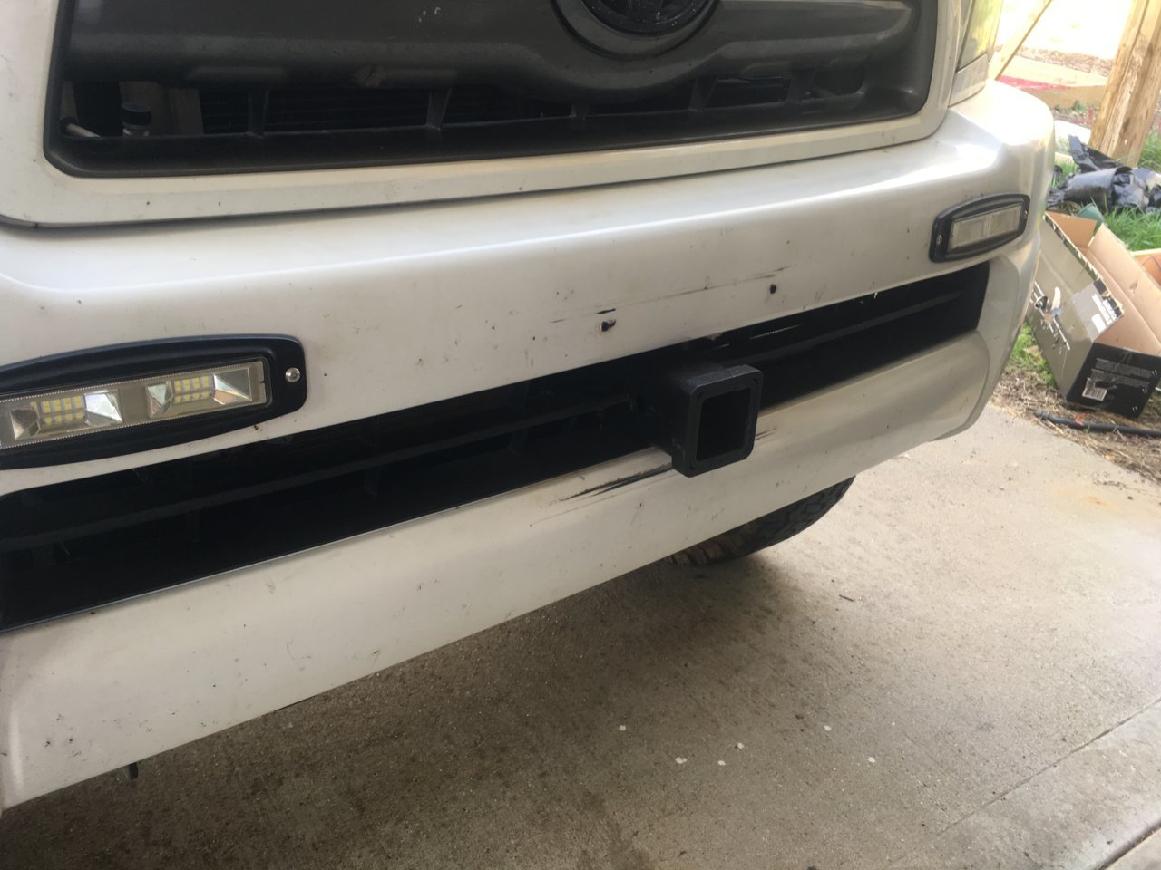

    The hardest part was mounting the rear buckle for the hitch mount. I had to put the bumper plastic in place and hold the hitch bracket in place. Then spot weld the rear mounting bracket from underneath in order to get it exactly right to match the cut out in my front bumper. (see pic img_6107.jpg)
    I cut a hole in the grill of the bumper to match the hitch bracket neck. The grill was flexible enough to bend it around the outside edge after mounting the hitch.
    Additional note, i've never done any steel work before and thought I should make it bulky. So I bought 4" square tube to begin with. That was WAY off. So I bought some 3" steel. To my, it's still too big. I should have gone with 2.5" and that would have probably allowed me to include brackets for the original bumper mounts. But the 3" fits perfectly.
    It's also good to note that I have a 2" Roger Brown body lift on my truck. So what you see here would be taller than a truck without a lift already in place.
    Hopefully this is helpful for someone out there! :):cheers:

    Looks pretty good to me, I like it!
