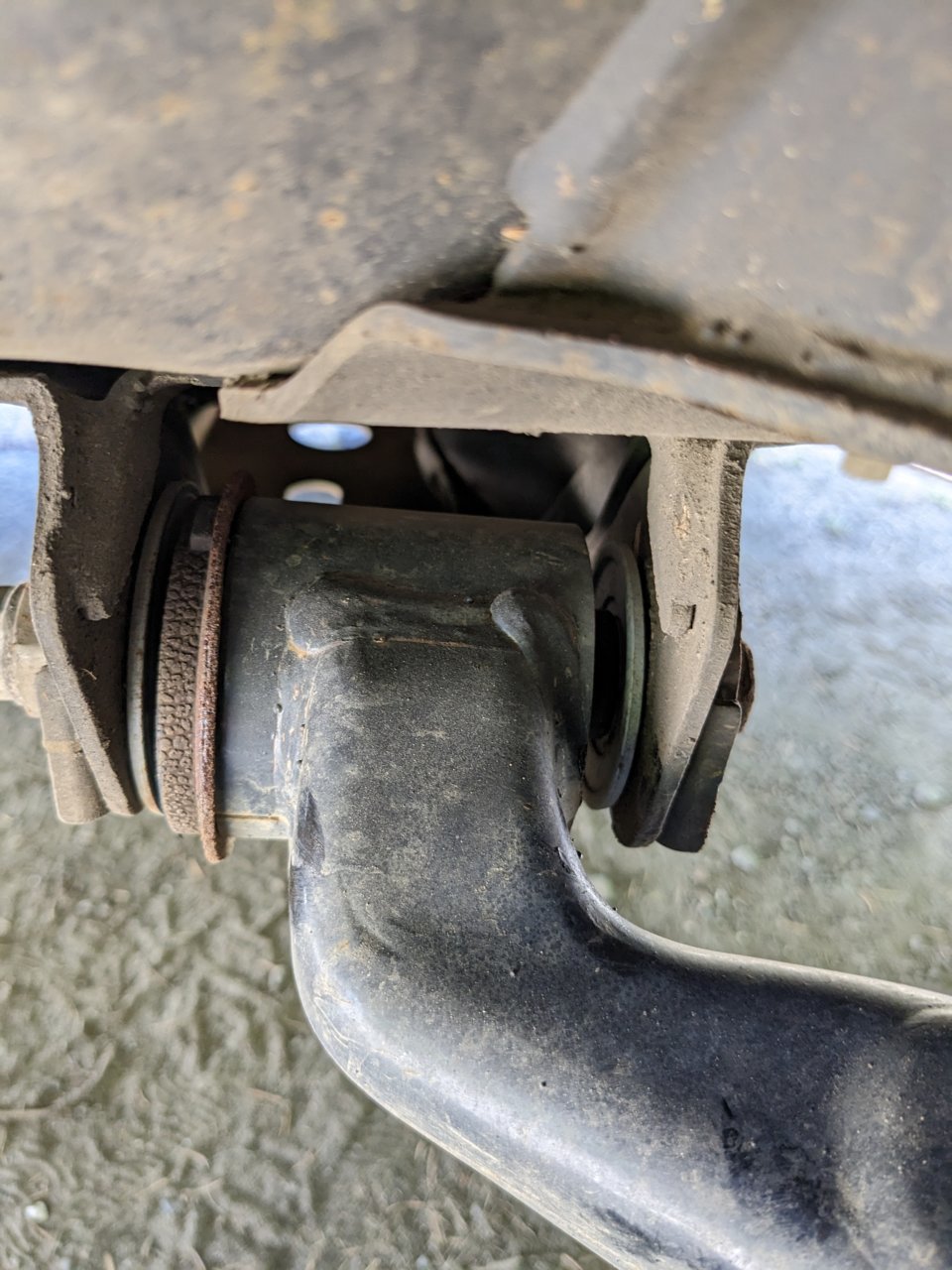

    Does this look right? Had new lower control arms installed recently and since then my steering has felt loose, and not as solid as before, trying to narrow down common or possible causesPXL_20230615_205403821.jpg

    That looks like a Moog bushing that's seen better days.
    If your steering feels loose Id look at the tie rods first.

    those bushings are definitely crusty

    Is there supposed to be that much space in-between attachment points

    Do these bushings come with new lower control arms? If so mine should have been replaced when Toyota replaced them

    Looks to me like the right side bushing has disintegrated and fallen out. See how dry and cracked the left one looks. Or someone forgot to put it in.

    Got your receipt from the repair? It should list all parts replaced and will show if the bushings were replaced. If not, then lookup the PN for the lower control arm to verify if it came with bushings preinstalled.
    If work was done at a dealership, you have a 1 year warrantee so take it back and ask what is going on and what they plan to do about it.

    OE Lcas come with bushings installed in them.

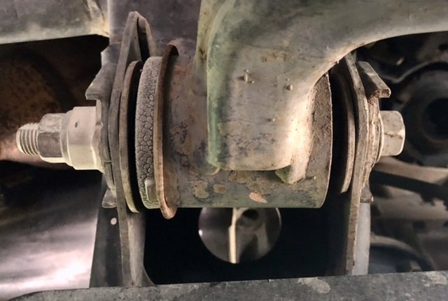

    Here is a pic from my 2022 with less than 5000 miles and my 2007 with 220,000 miles. Looks like gap on one side is normal.

    The gap on the right side is supposed to be there. That bushing looks like it has been on the road for years, how many miles have you driven since the LCA install?

    That texture is how the moog bushings look, I just put a set in my GX
    did you get an alignment after the install?
