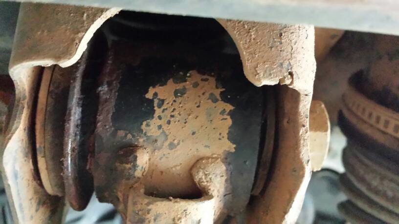

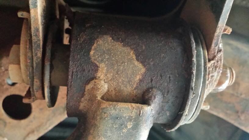

    Deathbysnusnu likes this.

    Nice video! Possibly the only one in existence that shows that clunk.

    I can only hope it helps. I started by taking video of the alignment cams, ball joints, tie rod, and wheel bearing. Lol lots of back and forth under the truck and trying to find a good spot to mount the camera.
    I just replaced the bushings when this started happening but I didn't think that this could be happening. I think I bent the LCA arms narrower in the process.

    So you're going to replace the LCA and bushing?

    Idk yet. I have some measurements from other people to make sure I didn't bend the arm. If it's bent I'll put a jack in it and try to put it back where it belongs. Otherwise Idk yet.
