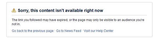

    . Here’s a video of the knocking noise I was trying to describe

    Can't view it.

    Try now made it public on my Facebook page.
