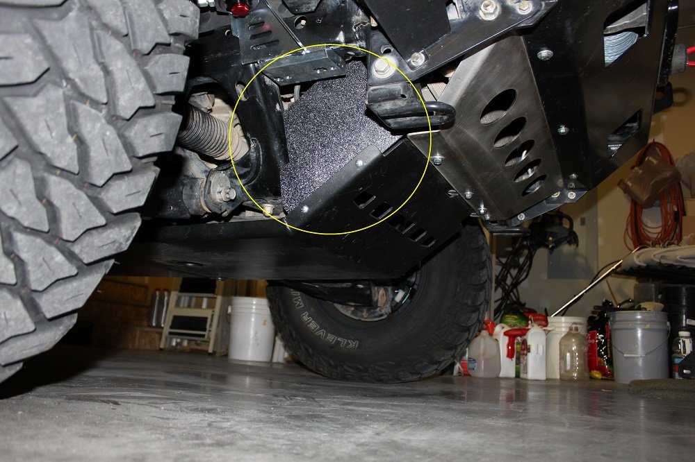

    BackOff
    BackOff Well-Known Member
    Jun 19, 2018
    #256888
    310
    Derek
    The corner of Idiocracy and the Twilight Zone
    2004 SR5 4Runner V6 4x4
    Noise mods/Weight Mods
    Story time with Derek.
    Just thinking out loud...so to speak.
    I have RCI skids, the front is really open to the effect of tire spray and mud splash, unlike the OEM front "skid" plate.
    I just added some wings using 1/4" ABS plastic sheet as a bit of splash guard.
    It is making the same sounds you are talking about, pulled the skid off, no noise... some sort of sympathetic harmonic vibration?
